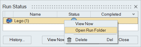

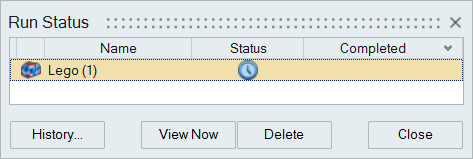

Run a Job Manually
Manually copy a prepared model file and queue it on a remote jobs server.
- You can start a manual remote run and close your local version of Inspire Cast. After copying the results back, you can load your results from the Run History.
- For more information about how to install and configure a remote job server, refer to the Inspire Cast Remote Job Submission Guide, available on Altair Community's Documentation page. Just filter for Inspire Cast and version 2022.1.
Windows
This references the batch file hwfdmfeprocessor.batInspireForm_Solver.bat found in <installation_directory>\Inspire2022.1\hwx\bin\win64 and a .zip file created for the remote job in the run directory specified in Preferences.
Linux
This references the shell file hwfdmfeprocessor.shInspireForm_Solver.sh found in $INSTALLDIR/altair/scripts and a .zip file created for the remote job in the run directory specified in Preferences.
