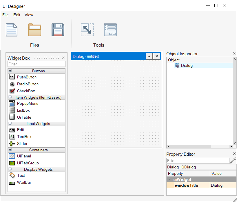

From the ribbon, select GUI Utilities > UI Designer.
The UI Designer opens in a new window.
Drag objects from the Widget box into the Dialog to create your GUI
design.

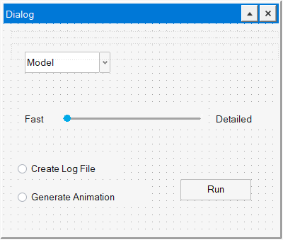

The following example shows a simple GUI with a list box, slider, radio buttons, push button and labels.

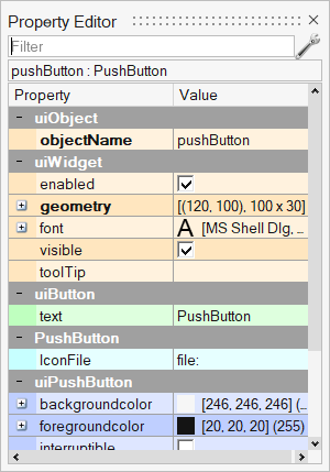

Modify the location, name, and properties of each object as required for your
design.
- To adjust location, select the object and move it with your mouse or arrow keys.
- To modify properties, select an object, then modify the desired
properties in the Property Editor.
You can also right-click an object and define a number of properties through the context menu.

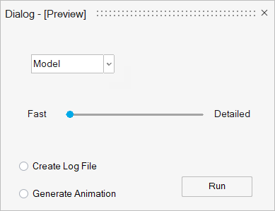

From the UI Designer ribbon, select the
Preview button.
A preview of your graphical user interface design is displayed. Review your design, then close the Preview window.
