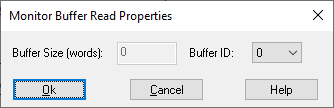

Buffer ID: Indicates the numeric ID of the buffer to read. This number must correspond to an existing Monitor Buffer Write block on the target.
Buffer Size: Indicates the number of words in the monitor buffer on the target. This is read-only.
