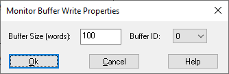

Buffer ID: Indicates the numeric ID of this buffer. The Buffer ID will be referenced by the Monitor Buffer Read block.
Buffer Size: Indicates the number of words to be allocated to the monitor buffer.
