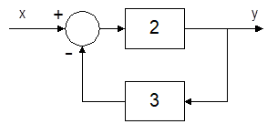

In control theory, the basic structure of a feedback loop in terms of a block diagram is shown below.
For the above structure, the output, y, can be expressed by the mathematical sentence: y is equal to twice the difference of x less three times itself. This sentence can be further reduced to the algebraic expression:
With simple algebraic manipulation, you can easily solve for y in terms of x such that:
For x=1, you can expect y to be precisely 2/7. You can build this same structure in Embed as shown below:

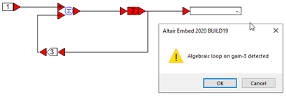

However, when you start the simulation, Embed immediately reports an algebraic loop.
Perhaps you expected Embed to solve this problem as easily as was done earlier by reducing the system to an algebraic expression and solving as done in the above equations. However, you are working with an algebraic expression, expressed in the form of a feedback loop. You could solve the structure algebraically to get:

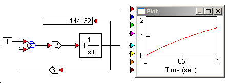

For the latter, let’s examine what’s going on in the following diagram:
If you plot the result over the simulation time, you see that the output appears to be heading towards the right solution:
The problem is you either need to increase the simulation end time or change the pole in the transferFunction block to provide faster convergence. Choosing the latter, confirms this expectation:

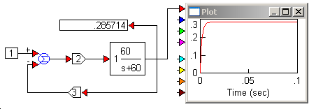

If the amplifier has a bandwidth of 60 rad/sec, you can represent it as a single pole (lag filter), as done earlier.
By introducing this filter in series with the gain and running the simulation, the algebraic loop is removed, a solution is obtained, and the dynamic features of the amplifier are embedded into the model.

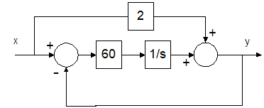

The lead-lag filter is causal but not strictly causal as illustrated by the following diagram derived from the selected filter.
In the structure of the lead-lag filter, you see that there is a path where the input propagates directly to the output with a gain of 2, but without any delay. This forward path leads to the algebraic loop when you connect the filter into a feedback loop that is free of blocks with memory.
In the lead-lag filter diagram, the lead-lag filter is expressed by the transfer function:
In linear control theory, the relative degree of this transfer function is 0. Relative degree is a measure of the difference between the orders of the denominator and numerator polynomials.
