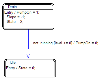

In the following example, a pump switches from draining mode to idle mode based on the transition specification:
trigger guard behavior transition spefication
The trigger not-running causes the pump to transition from ON to IDLE as long as the condition [level <=0] is TRUE.
