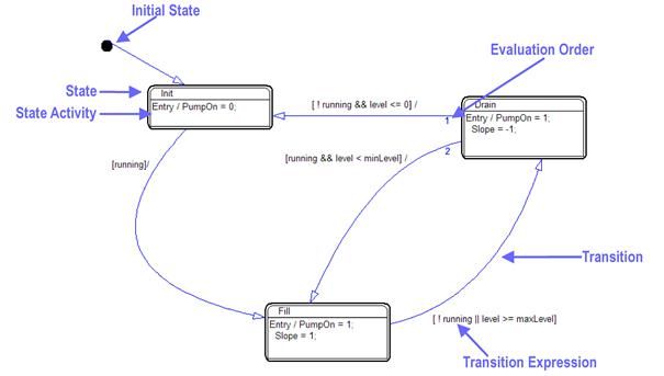

A state chart is a graphical representation of a finite-state machine — a system with a defined number of states, where transition from one state to another occurs when certain conditions are met. An example of a simple state chart is shown below:
