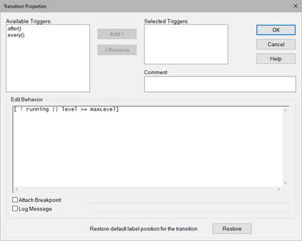

Attach Breakpoint: Sets a breakpoint the transition that causes the simulation to stop after the corresponding Embed time step is complete.
Available Triggers: Lists all triggers within the scope of the transition. There are two built-in triggers: after() and every()
Edit Behavior: Defines the transition specification. It can contain triggers, a Boolean guard, and a behavioral expression.
Log Message: Logs the specified message when a transition behavior is executed.
Restore: Repositions the transition specification label to its default location in the middle of the transition arc or line.
Selected Triggers: Lists the triggers associated with the transition.
