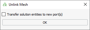

On the Unlink Mesh dialog, two options are
available:
Figure 1. The Unlink Mesh dialog.-
- Transfer solution entities to new port(s) check box cleared
- Unlink the mesh and create a separate mesh part. Mesh ports are created but the sources, loads and solution entities are not transferred.
- Transfer solution entities to new port(s) check box selected
- Unlink the mesh and create a separate mesh part. Mesh ports are created but the sources, loads and solution entities are transferred to the new ports on the separate mesh part. S-parameter configurations are updated accordingly.
When the simulation mesh is unlinked, the geometry ports connected to the selected geometry remain, but equivalent mesh ports are created with new labels. For example, if a geometry port has the label “Port1”, the mesh port is labelled “Port1_1”.
- Click OK to unlink the mesh and to close the dialog.
