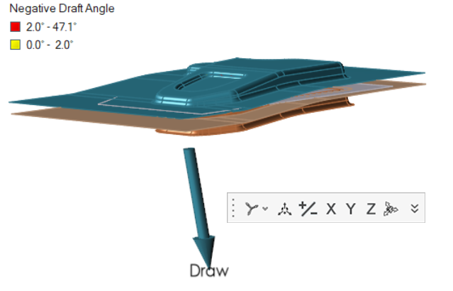

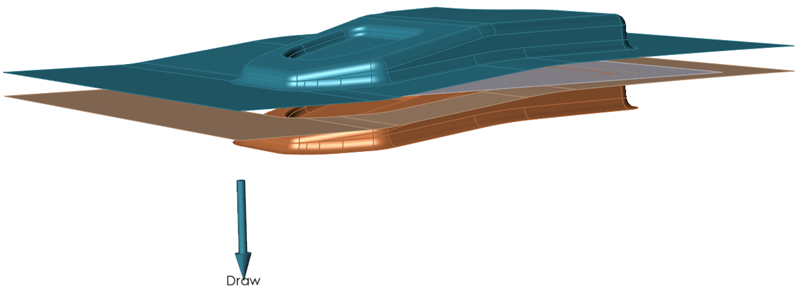

Define the Draw Direction
Define the direction for the top die or press slide to move in the model.
Microdialog Options
Select from the options to define the draw direction of the forming process.
| Icon | Description |
| Align the draw direction to a user-defined reference system. | |
Manually define the draw direction with the manipulator that appears on the model. |
| Reverse the draw direction. | |
Align the draw direction to the global X, Y or Z axes. |
Align to part |
Review the value for the the global X, Y or Z axes. |
