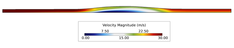

The AcuSolve solution converged to a steady state and the results
reflect the mean flow conditions. As the fully developed turbulent flow enters the
divergent section, the expansion of the cross-sectional height causes the streamwise
velocity to decrease. This causes separation of the flow along the cylinder wall and
results in an area of recirculation that eventually recovers downstream. After the
flow enters the diffuser, the velocity decreases significantly from the inlet
velocity, due to the rapid expansion of the cross section height in the divergent
section. A separation bubble forms within the diffuser, with decreased flow velocity
and increased pressure near the lower wall.
Figure 4. Velocity Contours Within the Diffuser

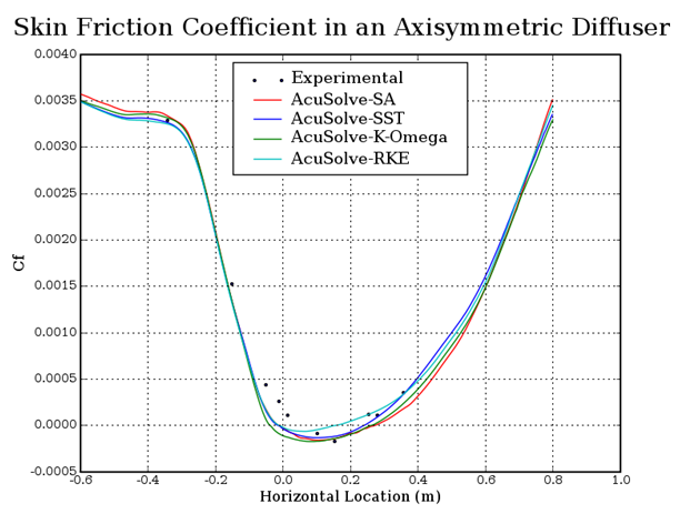

Upstream of the diffuser section, the streamwise velocity increases as the distance from the
cylinder wall increases, with no influence from the top wall of the diffuser. As the
flow enters into the divergent section, the streamwise velocity decreases near the
cylinder wall and changes direction in the recirculation region. Within the
recirculation region, the reduced speed of the streamwise flow causes the wall shear
stress to decrease and eventually change direction for a short distance along the

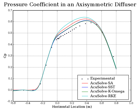

cylinder surface. The images below show the coefficient of pressure (Cp) and
coefficient of skin friction (Cf) along the cylinder wall in the diffuser compared
against experimental results. The non-dimensional values are defined by the
integrated inlet pressure and the magnitude of the inlet velocity. In the images
black circles represent the experimental measurements (Driver 1991), solid red lines
represent the prediction for the SA model, solid blue lines represent the prediction
for the SST model, solid green lines represent the prediction for the K-ω model and
solid cyan lines for the K-ε model, representing the AcuSolve results. There are minor differences in the
prediction of the pressure coefficient within the diffuser between the three
turbulence models. The SA model predicts a slightly higher value of pressure as the
flow separates from the cylinder wall compared to both SST and K- ω. The shearing on
the cylinder wall shows similar behavior, with the SA model predicting a slightly
longer recirculation region and with the K- ω model predicting the separation
further upstream. It was found that all three turbulence models predict the
separation point further upstream than what is shown in the experiment. This is
shown to be consistent with previous studies for each of the turbulence models used
(NASA 2014).
Figure 7. Coefficient of Pressure Along the Cylinder Wall Within the Diffuser
Section (Horizontal Location = ~ 2.7m at the Midpoint of the Expanded Region
of the Diffuser)
Figure 8. Skin Friction Coefficient Along the Cylinder Wall Within the Diffuser
Section (Horizontal Location = 0 at the Point Where Flow Separation is
Expected to Begin)
