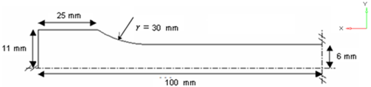

A quarter of a standard tensile test specimen is modeled using symmetry conditions. A traction is applied to a specimen via an imposed velocity at the left-end.
The units are: mm, ms, g, N, MPa.
Figure 1. Geometry of the Tensile Specimen (One Quarter of the Specimen is Modeled)

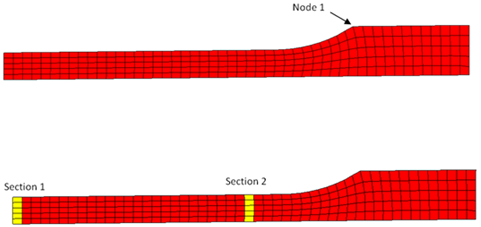

Figure 2. Sections of Node Saved for Time History

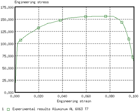

Figure 3. Engineering Stress Versus Engineering Strain Curve (Experimental Data)

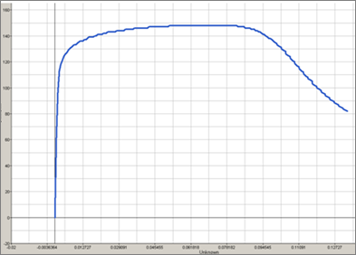

For the simulation results, engineering strains will be obtained by dividing the displacement of node 1 by the reference length (75 mm), and engineering stresses will be obtained by dividing the force in section 1 by its initial surface (10.2 mm2).
Figure 4. Engineering Stress Versus Strain Curve (Simulation Results)

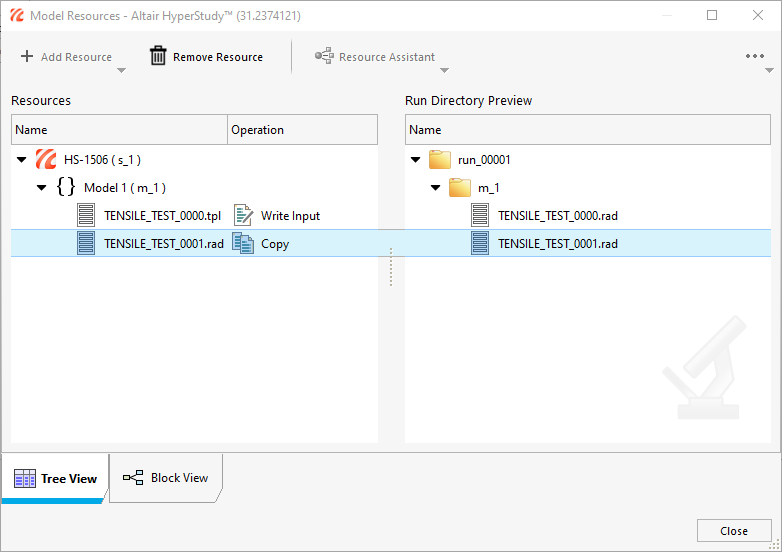

  5. Define a model dependency.
    1. Click Model Resources.
    2. In the Model Resource dialog, select Model 1 (m_1).
    3. Click Resource Assistant > Add File.
    4. In the Select File dialog, navigate to your working directory and open the TENSILE_TEST_0001.rad file.
    5. Set Operation to Copy.
    6. Click Close.
    Figure 9.

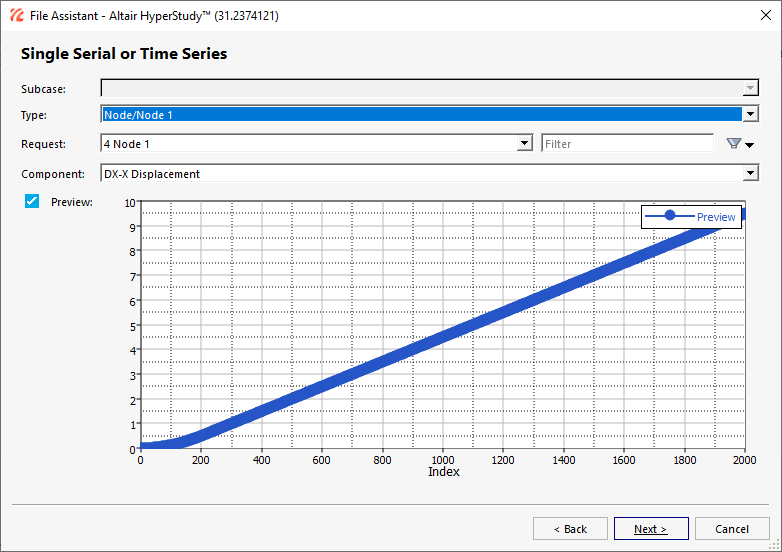

  2. Create a data source labeled Disp_sim.
    1. From the Directory, drag-and-drop the TENSILE_TESTT01 file, located in approaches/setup_1-def/run__00001/m_1, into the work area.
    2. In the File Assistant dialog, set the Reading technology to Altair® HyperWorks® and click Next.
    3. Select Single Item in a Time Series, then click Next.
    4. Define the following options, then click Next.
      • Set Type to None/Node 1.
      • Set Request to 4 Node 1.
      • Set Component to DX-X Displacement.
      Figure 11.
    5. Under Creating a new Data Source, enter Disp_sim in the Label field.
    6. Clear the Use Data Source in a new Response checkbox.
    7. Click Finish.
      Figure 12.

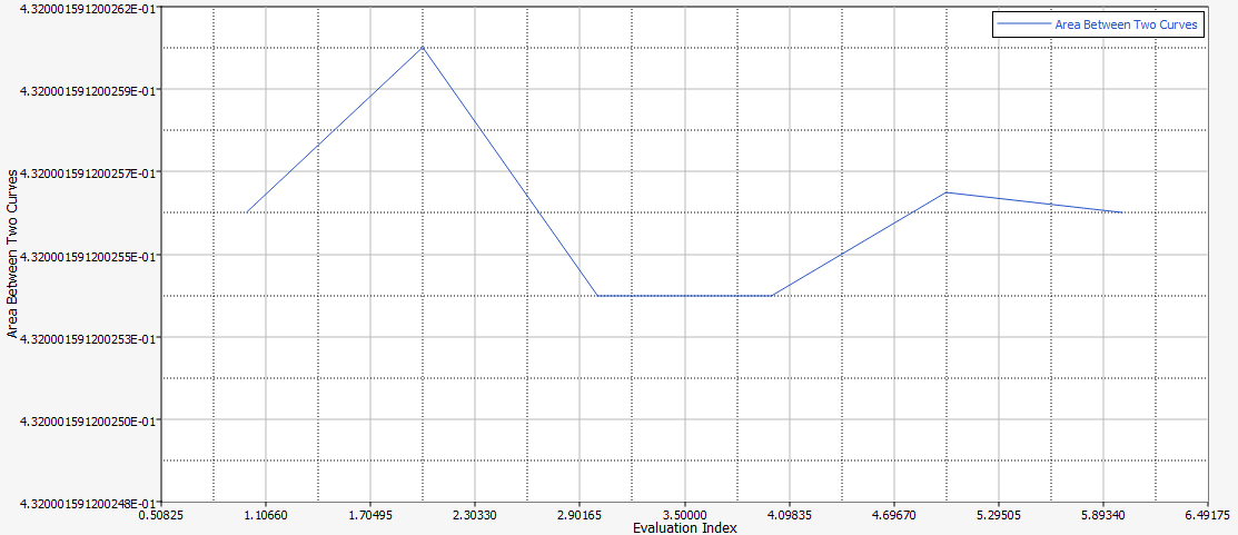

  10. Click the Evaluation Plot tab to plot the optimization iteration history of the objective.
    Figure 16.
