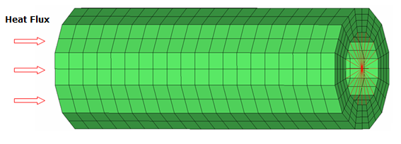

A coupled heat transfer/structure analysis on a steel pipe is performed in this tutorial.
As shown in Figure 1, the pipe is fixed on the ground at one end and the heat flux is applied on the other end.
Figure 1. Model Review

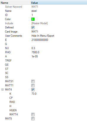

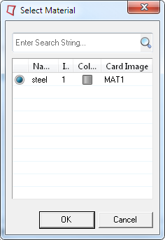

Create Coupled Thermal/Structural Material and Property

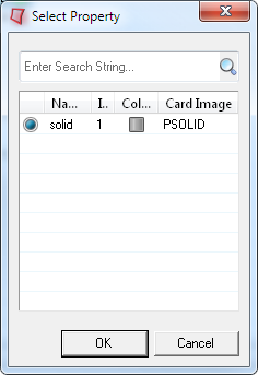

Link Material and Property to Existing Structure

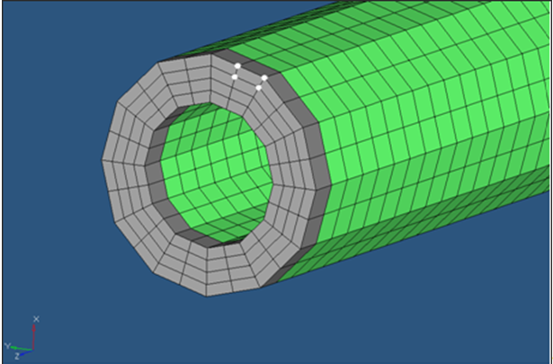

Apply Thermal Loads and Boundary Conditions to the Model

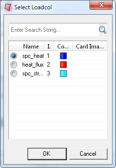

A structural constraint spc_struct is applied on the RBE2 element to fix the pipe on the ground. Two empty load collectors, spc_heat and heat_flux have been pre-created. In this section, the thermal boundary conditions and heat flux are applied on the model and saved in spc_heat and heat_flux, respectively.
and select
to open the
