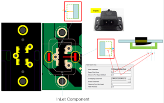

Figure 2.- Inlet Component: As shown in Figure 2, set the corresponding component.
- Expand InLet Area: Specify the size of the InLet Component's fixed pin to be expanded.
- Clearance from Expanded InlLet: Specify the separation distance that covers the bottom surface of the input component.
- Overlapping Component: When creating Soldering Pallet area, Pallet Area is created using Hole Variant Data. Pallet Area cannot invade the COC Area of the part. However, the part set as the overlapping component allows the invasion of the COC area.
- Clearance from Hole Variant: Distance between Hole Variant Barrier from hole Variant area.
- Pallet Thickness: Thickness of Hole Variant Barrier.
