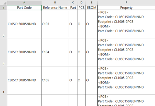

Export to Excel: Export the comparison result to Excel.
