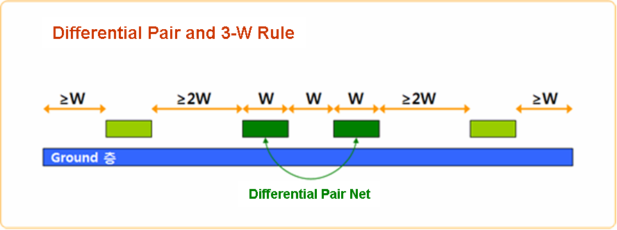

To design a Differential Pair Net, you must pay attention to keep the continuity of power and ground planes above and below of the differential net. Do not make branch stub to make test point. In other words, impedance for overall routing must be kept the same for the pair nets.
Figure 6.

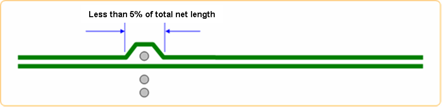

Reference Material
Parallelism will cause impedance discontinuities that will directly affect signal quality.
Figure 7.
