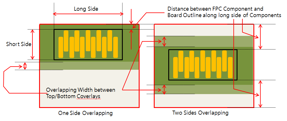

- Check Overlapping Width between Top and Bottom Coverlays: Check the
overlapping distance between top and bottom coverlays. If measured
overlapped distance is smaller than given value, it is fail.
- Distance between FPC Components and Board Outline along long
side of Component: To decide checking sides set the distance
between FPC component and board outline. After checking the
distance from long side of component to board outline, check
for the much distance long side than given value. If two
side distances are much longer than given value, check two
sides.
Figure 5.
sides.
