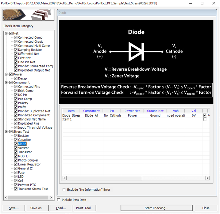

Diode
This item tracks the voltage and signal lines in the circuit, calculates the voltage value of each net, and checks whether the all diode connected to the net is within the allowable voltage range.
- Component: Select Diode component group to be checked.
- Pin: Assign pin
information of diode. User can assign pin number using Pin Number or Pin
Property which contain pin number information.

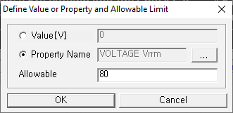

- Reverse Voltage
Check: Set the allowable reverse voltage of this diode. You can set this by
entering the allowable value directly or select the property name which
contain allowable reverse voltage value. You can also assign tolerance of
this check.

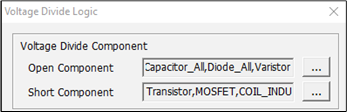

Figure 3. - Zener Voltage Check:
Set the allowable Zener voltage value of this component. You can set this by
contain allowable Zener voltage value. You can also assign tolerance of this
check.
Figure 4.

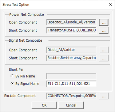

Stress Test Option
Set whether passive components are considered short or open when navigating signals and power lines.
