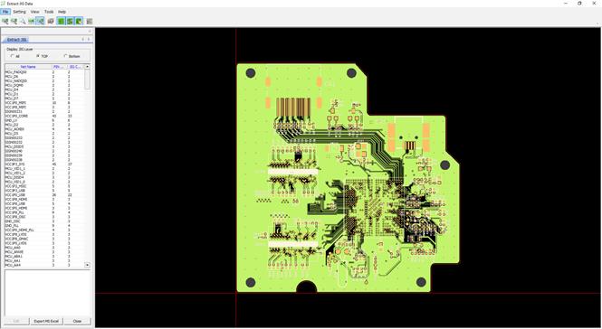

From the menu bar, click Manufacture > Test-Point Location Generator > Extract JIG Data.
From the menu bar, click Tools > Extract JIG Data.
The extracted JIG data are displayed on the left-side of the
Extract JIG Data dialog. Figure 1.

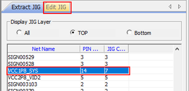

Edit JIG Data.
Select VCC1P8_SYS from the list.
The Edit JIG tab displays. Figure 2.

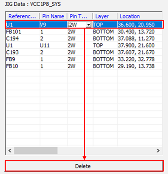

Click U1 and click Delete
to delete the JIG data from the list.
Figure 4.

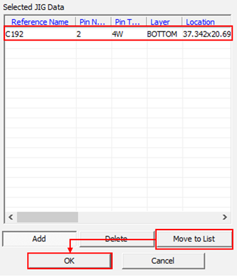

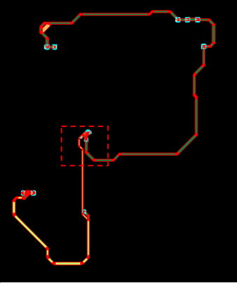

Click Add and click
C192.
The C192 is in the red-dotted area. Figure 6.
The selected JIG pin is added in the Selected JIG Data.
Click Move to List to apply the added JIG data
into the selected net and click OK.
Figure 7.

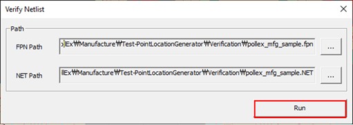

Click in the FPN Path row and select the
pollex_mfg_sample.fpn file in the following
directory:
C:\Temp\Altair-PollEx\Manufacture\Test-PointLocationGenerator\Verification.
Click Open.
Click Run.
If the NET Path is not defined, select the same directory as the
*.FPN file. Figure 8.
The Verification Result is displayed in the tab.

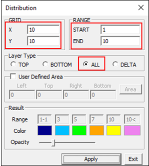

Define distribution.
From the menu bar, click Tools > Distribution.
The Distribution dialog opens.
In the Distribution dialog, select
ALL for Layer Type and enter the following
GRID and Range values:
X = 10
Y = 10
START = 1
END = 10
Figure 9.
Click Apply.

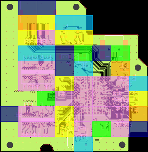

Check the distribution of the JIG data in the PDB design.
Figure 10.

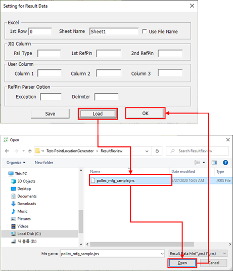

From the menu bar, click Setting > Setting for Result Data.
Click Load and select the
pollex_mfg_sample.jrrs file from the following
directory:
C:\Temp\Altair-PollEx\Manufacture\Test-PointLocationGenerator\ResultReview.
Click Open and click OK.
Figure 13.

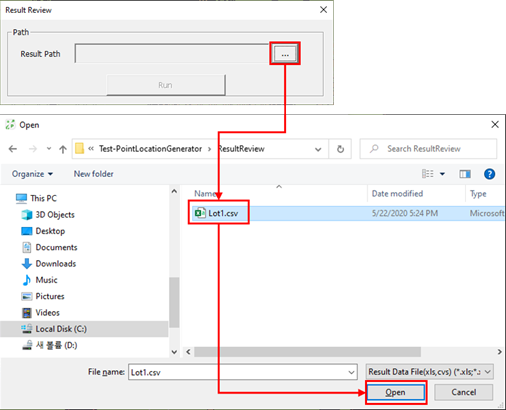

In the Result Review dialog, click to select the Lot1.csv
file.
Click Open.
Figure 14.
