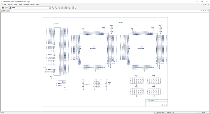

Start PollEx Logic.
From the menu bar, click File > Import CAD > SDB Binary.
Open the LDFE_Sample.sdbb file from
C:\Temp\Altair-PollEx\PollExLDFE\LDFE_Sample.sdbb.
The LDFE_Sample schematic is displayed as shown below. Figure 1.
From the menu bar, click Tools > Schematic Data Extractor to preview schematic design and see information about Components
and Nets.
To setup Logic DFE input, you must review the current design. The sample
design consists of CPU and two DDR3 memories.

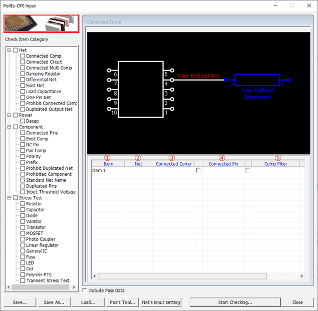

Preview Connected Comp item. Normally, the easiest way to generate a reference
voltage is to use Voltage Divide Logic using resistor network.
In this case, the resistor should have 1% tolerance to ensure the accuracy of
the output voltage value. You can check this requirement using the Connected
Comp item.

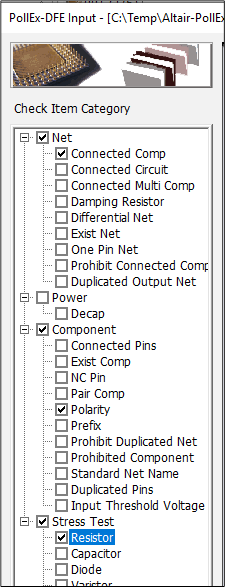

In the Check Item Category section, enable the Connected
Comp checkbox.
The Connected Comp Item Rule Entry dialog
opens in the Input dialog.

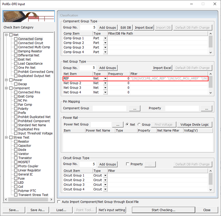

Define net groups.

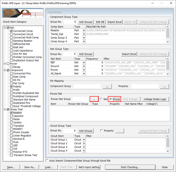

In the PollEx-DFE Input dialog, click the
classification menu.
Figure 3.
The PollEx-DFE Input dialog
opens.

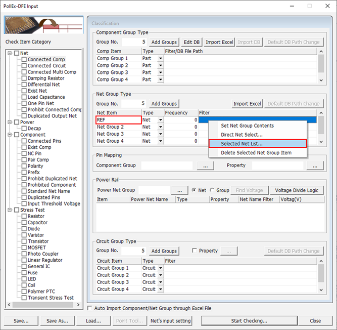

Define REF net group.
In the Net Group Type section, double-click Net
Group01 and change the group name to
REF.

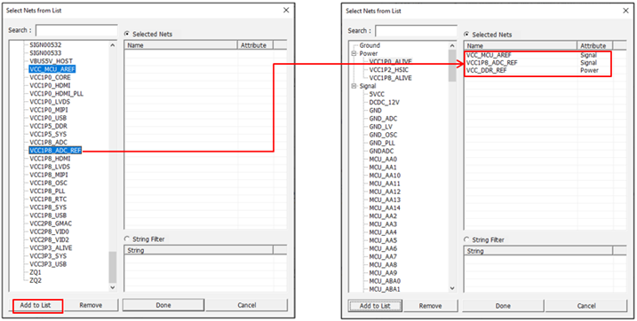

From the Net Name list, select REF.
From the Filter tab, right-click and select Select Net
List from the context menu.
Figure 4.

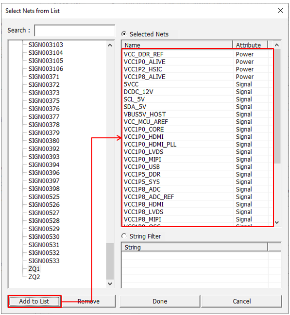

Select Selected Net List.

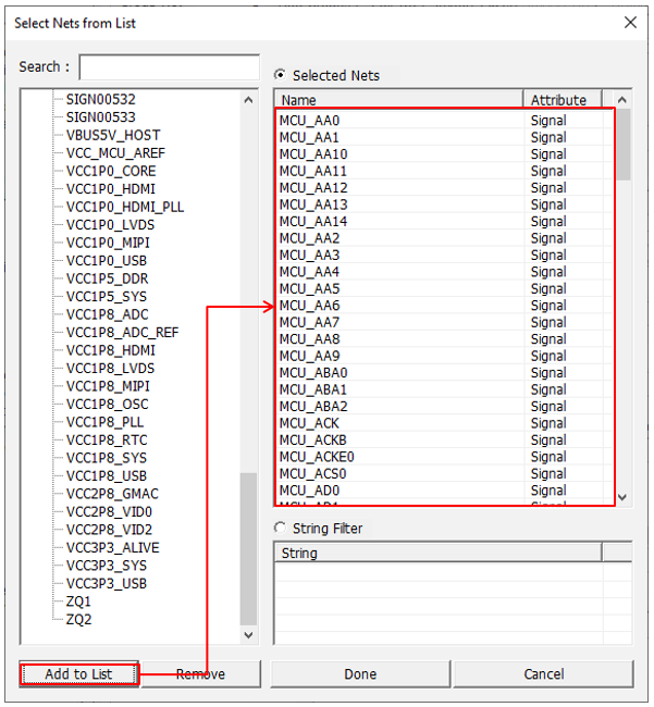

Select the following nets from the net list:
VCC_MCU_AREF,
VCC_DDR_REF, and
VCC1P8_ADC_REF.
Click Add to List.
Figure 5.
Click Done.
The selected list will register as net group, REF. Figure 6.

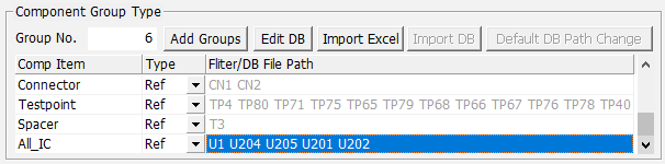

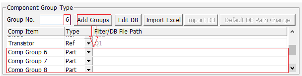

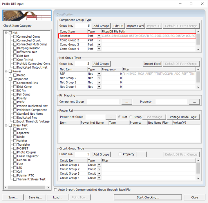

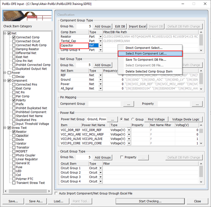

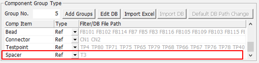

Define Resistor component group.
In the Component Group Type section, double click Component
Group 1 and change the group name to
Resistor.

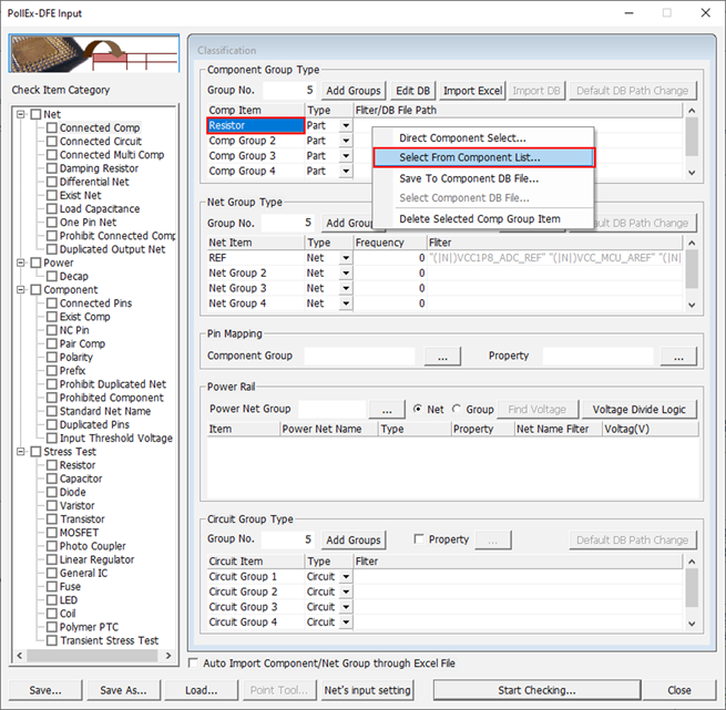

From the Comp Name list, select Resistor.
From the Filter/DB File Path tab, right-click and select
Select From Component List from the context menu.
Figure 7.

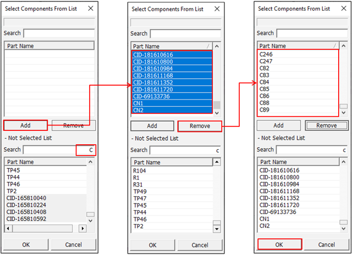

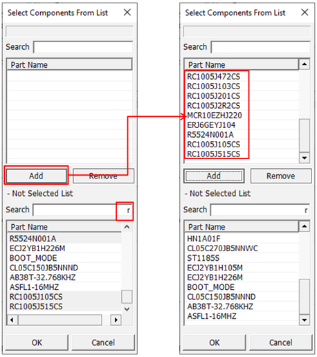

Select Selected Component from List.
In the Search field, enter R and click
Add.
Figure 8.
Click OK to close
this window.
The selected list is registered as a component group with name,
Resistor. Figure 9.

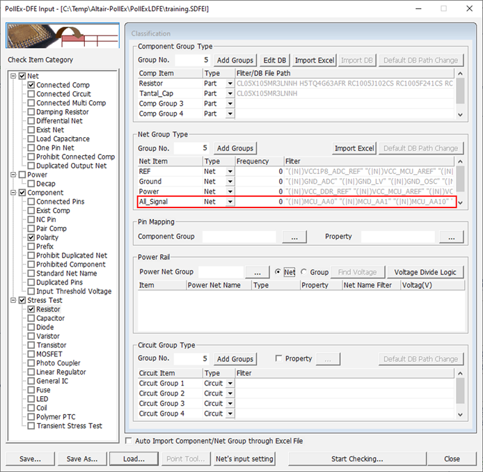

Set Connected Comp item test condition.
Click Connected Comp item.
The Connected Comp Item Rule Entry dialog opens
in the PollEx Logic DFE Input dialog. Figure 10. Figure 11.

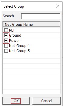

Double-click the Net field of the first
item.
The Select Group dialog opens.
Select the REF net group and click
OK.
Double-click the Item field of the first item
and enter Vref_Resistor_Tolerance for the name of
the sub-item.

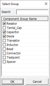

Double-click the Connected Comp field of the
first item.
In the Select Group dialog, select the
Resistor component group and click
OK.

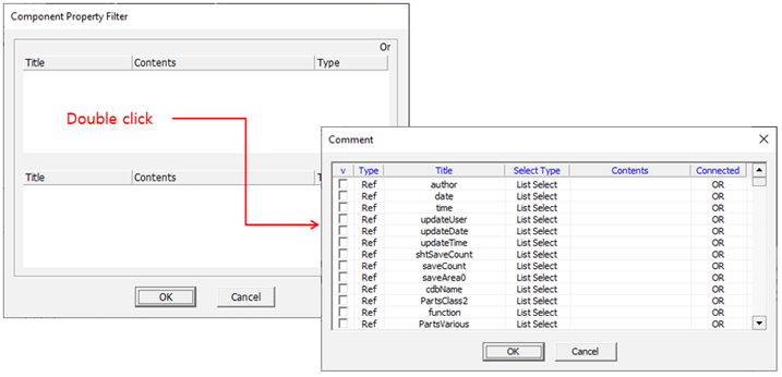

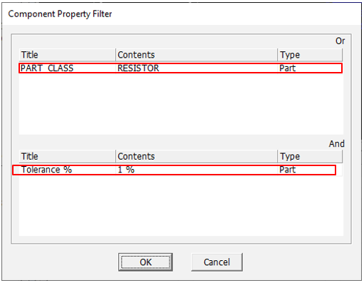

Enable the Comp Filter checkbox and double-click
the Comp Filter field of first item.
The Component Property Filter dialog
opens. Figure 12.

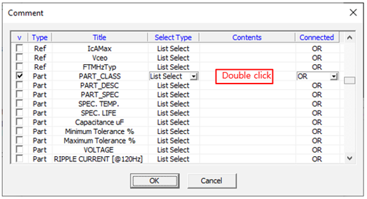

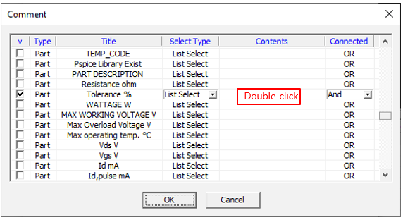

Double-click the empty field.
The Comment dialog opens. Figure 13.
Select Part_CLASS from the drop-down list of the
Title column and enable the checkbox.
In the Select Type column, select List
Select.
In the Connected column, select OR.
Figure 14.

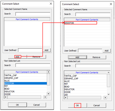

Double-click the field in the Contents
column.
The Comment Select dialog
opens.
Under Part Comment Contents, select RESISTOR and
click Add.
Figure 15.
Click OK to close
Comment Select dialog.
In the Comment dialog, enable the
Tolerance % checkbox.
For Select Type, select List Select.
For Connected, select And.
Figure 16.
Double-click the Contents field.
opens.

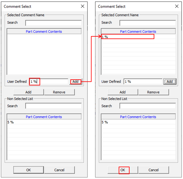

In the Comment Select dialog, enter
1% string in the User Defined field and click
Add.
Figure 17.
Click OK to close the
Comment dialog.
In the Component Property Filter dialog,
the new PART_CLASS property is added in the OR section. Tolerance % is
added in the AND section of the Component Property
Filter dialog. Figure 18.
Component Property Filter dialog.
Enable the Include Pass Data checkbox.
Figure 19.
With this setting, PollEx Logic DFE
checks if a 1% tolerance resistor is connected to the voltage divide
logic for REF signal group.

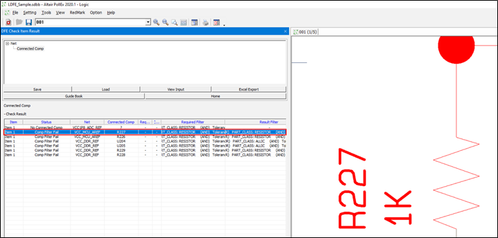

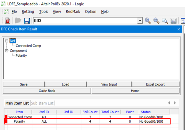

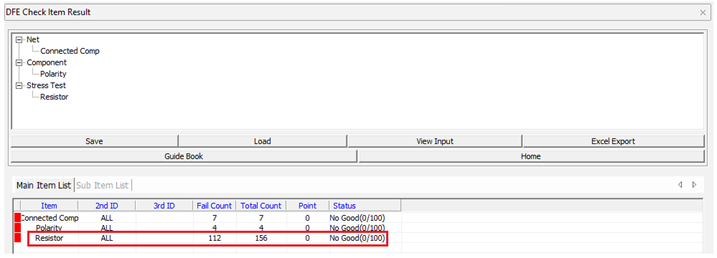

Run Connected Comp Item and review Check Result.
Click Save As and save the input file as
training.SDFEI in the
PollExLDFE folder under job folder.

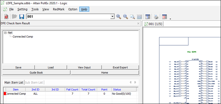

Click Start Checking.
PollEx Logic DFE begins checking for
selected checking items. After running, the results display. Figure 20.
In the result tab, click Connected Comp in the
Item column.
The detail error list displays.

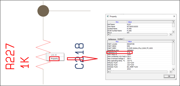

Click the error item R227 in the Connected Comp
field.
Figure 21.
Select R227, right-click and select
Select Property from the context menu.
The Property dialog opens.
In the Symbol tab of the Property dialog, review
the property of the R227 component.
The R227 component should have a 1% tolerance, but with a 5% tolerance
the result is failed.
Property dialog.
Figure 22.
In the result tab, click the No Connected Comp
error item.
There is no resistor connected to VCC1P8_ADC_REF net, so the result is
failed. Figure 23.

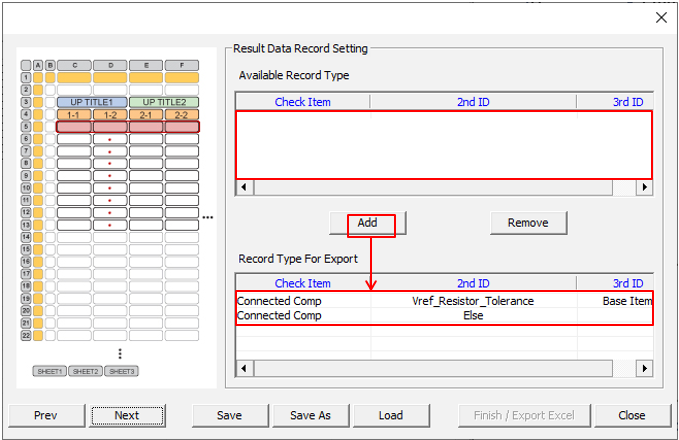

Result Data Record setting.
The upper section shows total available result items. And the lower section
shows selected item for excel report. You can manually select the items to be
included in the excel report by clicking Add. Enable the
Automatically record all available Contents to
MS/Excel checkbox to automatically select all items. Figure 27.
Click Next.

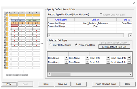

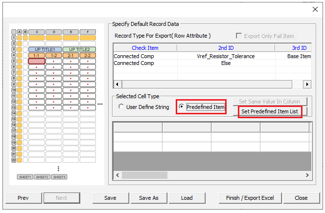

Specify Default Record Data.
Select Predefined Item and click Set
Predefined Item List.
The Predefined Item dialog opens. Figure 28. Figure 29.
Click Remove All.
Select all items available in the left section of the dialog except
first item named [BLANK] and click Add.
Select Apply Set Same Value in Column.
Your settings should now look as follows: Figure 30.
Click OK.
Figure 31.

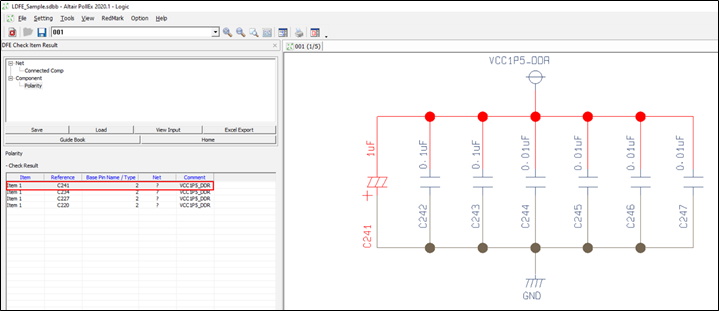

Check Polarity
Polarity check
In the result tab, click View Input.
The PollEx-LDFE Input dialog
opens.
Enable the Component and
Polarity checkboxes.
The Polarity item rule entry dialog
opens. Figure 33.

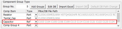

Define Tantal_Cap component group.
Group 2 and change the group name to
Tantal_Cap.
Right-click in the Filter/DB File Path field and
select Select From Component List.
Figure 35.
Select the CL05X105MR3LNHN component from part
name list in lower section and click ADD.
Figure 36.
Click OK.
The selected list is registered as component group Tantal_Cap.

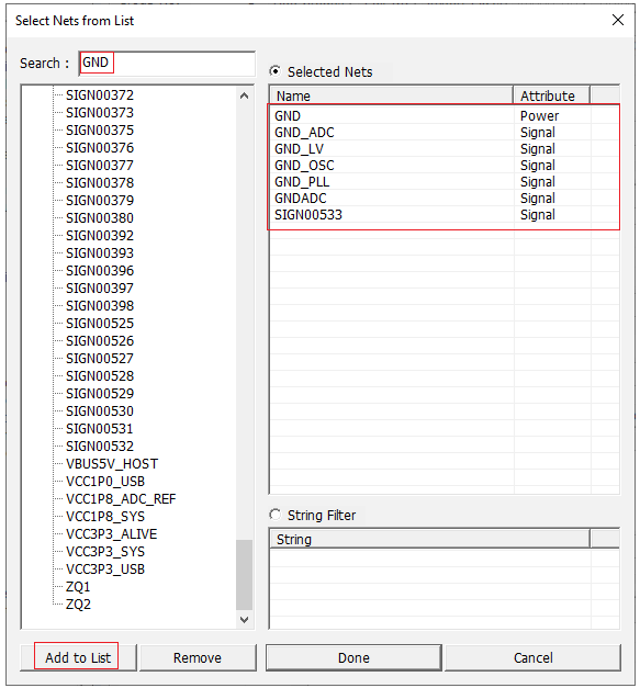

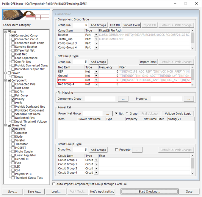

Define Ground net group.
In the Net Group Type section, double click Net Group
Ground.
select Select Nets List.
The Select Nets from List dialog
opens.
In the Select Nets from List dialog, enter
GND in the Search field.
Click Add to List.
Figure 37.
Click Done.
The selected list is registered as net group Ground.

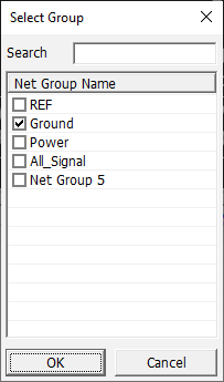

In the Polarity Item Rule Entry dialog,
double-click the Net field.

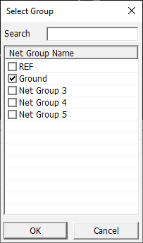

The Select Group dialog opens. Figure 40.
Enable the Ground checkbox and click
OK.

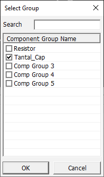

Double-click the Comp field in the
Polarity Input Setup dialog.
In the Select Group dialog, enable the
Tantal_Cap checkbox and click
OK.
Figure 41.

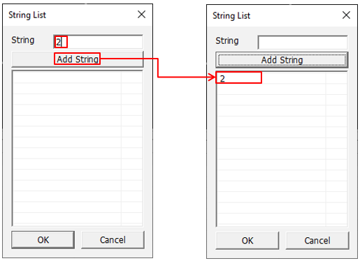

Choose the Pin Name.
Figure 42.
Double-click the Pin Name field in the
The String List dialog opens.
In the String List dialog, enter
2 for String and click Add
String.
String List dialog.

Run Polarity Item and review Check Result.
PollEx Logic DFE starts checking for
display.
In the result tab, click Polarity to see the
detailed result.
Figure 44.
In the result tab, click C241 in the Reference
field.
The positive pin of C241 is incorrectly connected to the ground, so it
has failed. Figure 45.

In the Result tab, click View Input.
The PollEx-DFE Input dialog opens.
Enable the Stress Test and
Resistor checkboxes.
The Stress Test/Resistor Item Rule Entry dialog
opens. Figure 46.

In the Net Group Type section, double-click Net Group
3 and change the group name to
Power.
Right-click the same line and select Selected Net
Select the following power nets: 5VCC,
DCDC_12V, SCL_5V,
SDA_5V, VBUS5V_HOST,
and all other nets whose name is begin with VCC string.
Click Add to List and click
Done.
Figure 48.
The selected list is registered as the Power net group. Figure 49.
Define All_Signal net group.
4 and change the group name to
All_Signal.
Select all signal nets except all power and ground nets.
Done.
Figure 50.
The selected list is registered as All_Signal. Figure 51.
Setup Power Voltage Level.
In the Power Rail field, select Group in the
Power Rail section and click .
The Select Group dialog opens. Figure 52.
Enable the Power and
Ground checkboxes and click
OK.
Figure 53.

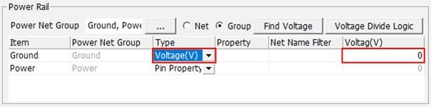

The selected net groups are displayed in the Power Rail
section.
For Ground, select Voltage(V).
This means that voltage will be assigned for all ground nets.
For Voltage (V), enter in 0.
Figure 54.

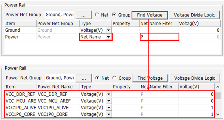

For Power, select Net Name.
For Net Name Filter, enter P.
This means that voltage value is included in net name string by the
rule of Number+P+Number.
Click Find Voltage to extract voltage value for
power and ground net.
All net names and voltages belonging to the Power and Ground net
groups are displayed in Power Rail section. Figure 55.
Define Capacitor component group.
In the Component Group Type section, click Component Group
Capacitor by double-clicking the
name column.
For Capacitor, select Ref in the Type
column.
Right-click the same line and select Select from Component
Figure 56.
In the search field, enter C.
Click Add.
All components whole refedes name begin with C will be
selected.
Select all components which Refedes names begin with CID- and CN and
click Remove to remove the selected components
from selected list.
Figure 57.
Click OK.
Capacitor. Figure 58.

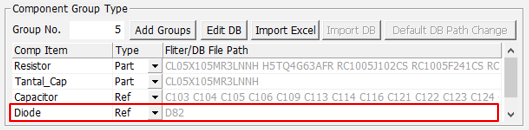

Define Diode component group.
Diode.
For Diode, select Ref in the Type column.
Right-click the same line and select Selected Component from
In the search field, enter D at Search
field.
Select all components with Refedes names starting with CID- and LED and
from the selected list.
Click OK.
The selected list is registered as the Diode component
group. Figure 59.

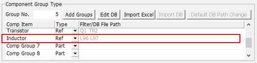

Define Inductor component group.
In the Group No. field, enter 6 and click
Add Groups.
Figure 61.
6 and change the group name to
Inductor.
For Inductor, select Ref in the Type
column.
In the search field, enter L and click
Add.
Select all components with Refedes names starting with FL and LED and
click Remove.
Click OK.
The selected list is registered as component group Inductor. Figure 62.

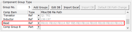

Define Bead component group.
7 and change the group name to
Bead.
For Bead, select Ref in the Type column.
In the search field, enter FB and click
Add.
Click OK.
The selected list is registered as component group Bead. Figure 63.

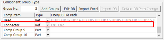

Define Connector component group.
8 and change the group name to
Connector.
For Connector, select Ref in the Type
column.
In the search field, enter CN and click
Add.
Click OK.
Connector. Figure 64.

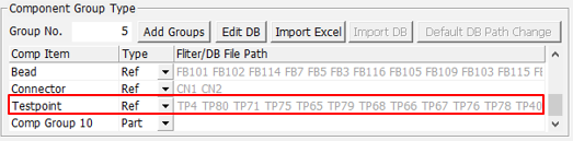

Define Testpoint component group.
9 and change the group name to
Testpoint.
For Testpoint, select Ref in the Type
column.
In the search field, enter TP and click
Add.
Click OK.
Testpoint. Figure 65.
Define Spacer component group.
10 and change the group name to
Spacer.
For Spacer, select Ref in the Type column.
In the search field, enter T and click
Add.
Select all components with Refedes names starting with TP and TR and
click Remove.
Click OK.
The selected list is registered as component group Spacer. Figure 66.
Define IC component group.
11 and change the group name to
All_IC.
For All_IC, select Ref in the Type column.
In the search field, enter U and click
Add.
Click OK.
The selected list is registered as component group All_IC. Figure 67.
In the Check Item Category list, enable the Stress Test
and Resistor checkboxes.
Figure 68.
opens.

The Select Group dialog opens. Figure 70.
Resistor checkbox and click OK.

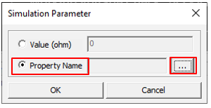

The Simulation Parameter dialog opens. You can
assign a resistor value by entering resistor value or specifying the property
name where the resistor value is defined. Figure 71.
Select Property Name and click .

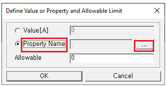

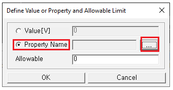

Enable the checkbox in the Working Voltage Check field and double-click the
Working Voltage Check field.

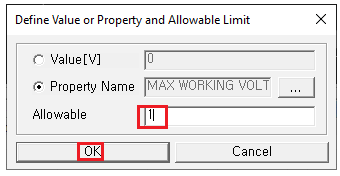

The Define Value or Property and Allowable Limit
dialog opens. You can assign maximum allowable rated Working Voltage level by
entering value or specifying the property name where the Working Voltage value
is defined.
Select Property Name option and click .

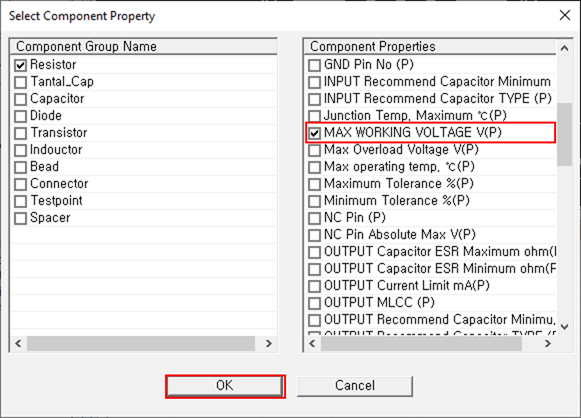

The Select Component Property dialog opens. Figure 79. Figure 80.
Enable the Resistor and MAX WORKING VOLTAGE
V(P) checkboxes and click OK.
In the Define Value or Property and Allowable Limit
dialog, enter 1 for Allowable.
This means the allowable maximum working voltage is 1% of its rated Working
Voltage value. Figure 81.
Click OK.

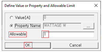

Enable the checkbox in the Power Dissipation Check field and double-click the
Power Dissipation Check field.
dialog opens. You can assign maximum allowable rated Power Dissipation level by
entering value or specifying the property name where the Power Dissipation value
is defined.

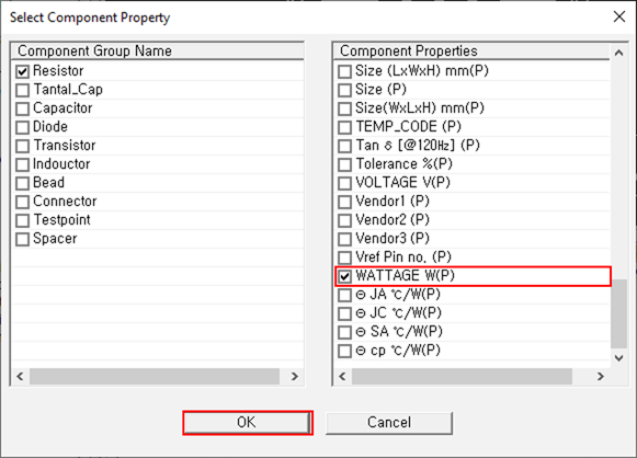

The Select Component Property dialog opens. Figure 82. Figure 83.
Enable the Resistor and WATTAGE
W(P) checkboxes and click OK.
For Allowable, enter 1.
This means the allowable maximum working voltage is 1% of its rated Power
Dissipation value. Figure 84.
Click OK.

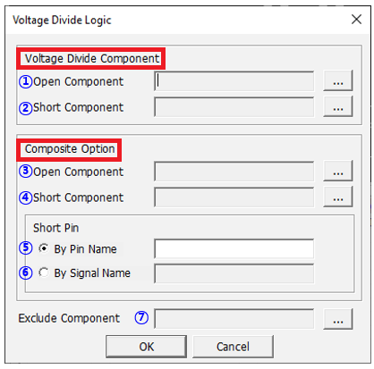

Upon double clicking this field. Figure 85.
In the Power Net Composite section, click for Open Component.
The Select Group dialog opens. You can assign
component group that will be considered as open state during searching voltage
rail. Figure 86.
Enable the Resistor, Capacitor,
and Diode checkboxes and click OK.

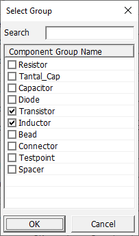

In the Power Net Composite section, click for Short Component.
component group that will be considered as short state during searching power
rail. Figure 87.
Enable the Transistor and
Inductor checkboxes and click OK.
In the Signal Net Composite section, click for Open Component.
component group that will be considered as open state during searching signal
net. Figure 88.
Enable the Diode checkbox and click OK.
In the Signal Net Composite section, click for Short Component.
component group that will be considered as short state during searching signal
net. Figure 89.
Inductor, and Bead checkboxes
and click OK.

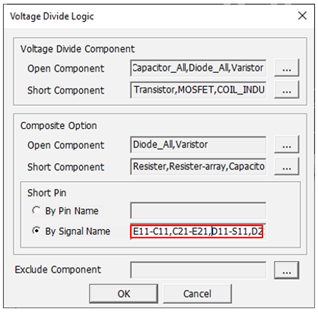

Select By Signal Name in the Short Pin section.
This means that we will define pin-connection information for multi-pin
component by signal name. For example, for the following multi-pin component,
the short pin pairs are C11-E11, C21-E21, D11-S11, and D21-S21. Figure 90.
For By Signal Name, enter E11-C11,
C21-E21, D11-S11,
D21-S21.
Figure 91.

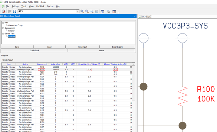

Run Stress Test/Resistor Item
In this step, you will run a stress test/resistor item and review the check
result.
PollEx Logic DFE starts checking for selected
checking items. After running, PollEx Logic DFE changes
its window for results display.
In the Result tab, click the Stress Test/Resistor item
to see the detailed result.
Figure 93.
To review the error, click on the error item marked R100
in the Component field of the Result tab.
In the right window, you can see the error location and a picture. Review the
list on the left and see the Working Voltage of R100 is 3.3V, but allowed
Working Voltage is 0.5V, so it fails. Figure 94.
