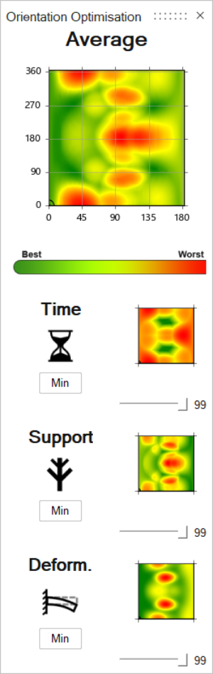

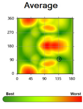

Optimize Orientation
Optimize the orientation of the print part to minimize print time, supports, and/or deformation. You can also orient the part based on a weighted average of all three factors.

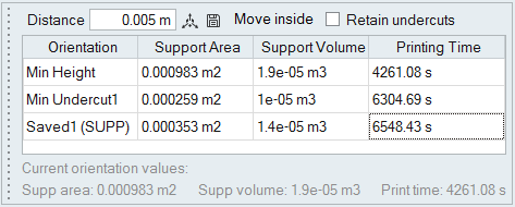

Save an Orientation
Use the Orientation table to save the orientation of the print part .

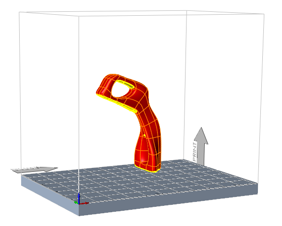

- For surfaces on the part with angles of less than 45 degrees, support is
required. These areas are shown in yellow and update automatically as the
part is rotated using the Move
tool. - If the part accidentally extends outside of the printing bed, select the Move Inside option on the Orientation table to place it inside of the printing bed.
- By default, undercuts are only shown in yellow when the Orientation tool is active. Enabling the Retain Undercuts option on the Orientation table makes the undercuts visible when using other tools. This is useful when you are modifying the geometry and want to see how the undercuts change as a result.
- If you rotate the part or create new orientations, the Current orientation values at the bottom of the table update automatically. Select a row in the Orientation table to restore that orientation.
