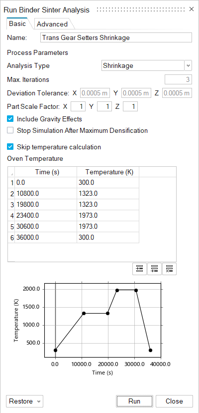

Process Parameters
Process parameters impact what result types are available at the end of the simulation, as well as the processing time and accuracy of results.
Basic
- Analysis Type
- Choose between a shrinkage analysis or a compensation analysis.
Compensation analyses will run several iterations to find the optimal
compensation for expected deformation/densitization.Note: A compensation analysis is required to use the Green Part tool.
- Max Iterations
- Enter the maximum number of iterations the solver will run. The default is 3.
- Deviation Tolerance
- Enter the limit of acceptable deviation. If the part’s deviation reaches this tolerance, the simulation will end. Deviation Tolerance only appears in compensation analyses.
- Part Scale Factor
- Scale the part’s dimensions to compensate for expected shrinkage.
- Include Gravity Effects
- Tell the solver whether to include gravity in its calculations. Gravity is included by default.
- Stop Simulation After Maximum Densification
- If this is checked, the solver will stop the simulation once the part has reached its maximum relative density.
- Skip Temperature Calculation
- If this box is checked, the solver assigns temperature based on the open curve. Otherwise the solver computes the temperature by solving the energy equation.
- Oven Temperature
- Set the oven’s temperature at specified time points, measured in seconds from the start of the simulation.

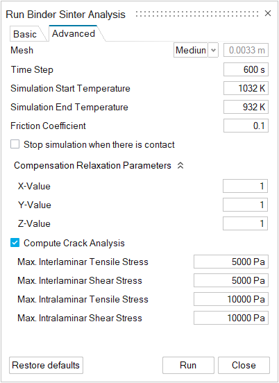

Advanced
- Mesh
- Set the mesh to fine, medium, or coarse, or define a custom mesh.
- Time Step
- Enter the duration of each time step in seconds.
- Simulation Start Temperature
- Set the temperature at which the simulation will begin. This combined with Simulation End Temperature allows you to run the analysis only on a select portion of the simulation.
- Simulation End Temperature
- Set the oven’s final temperature for the analysis. The solver takes the temperature curve into account and ends the analysis when the temperature is trending down.
- Friction Coefficient
- Defines the friction between the part and the build platform. This affects the part's deformation.
- Stop simulation when there is contact
- Enable this option to stop the simulation if the part deforms enough for it to come into contact with itself or the oven base.
- Relaxation Parameters
- These parameters control the compensation applied at each iteration during a compensation analysis. Enter a value between 0.1 and 10 to change the compensation factor in the simulation. Used only in a compensation analysis.
- Compute Crack Analysis
- Tell the solver to compute a cracking analysis. Use the fields to set the maximum allowable tensile and shear stress allowed within and between powder layers.
