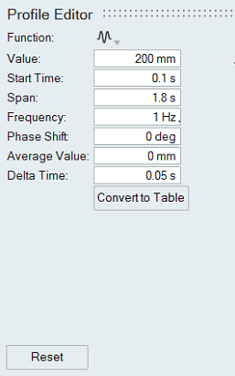

- You can change the parameters of a profile function using the Property Editor.

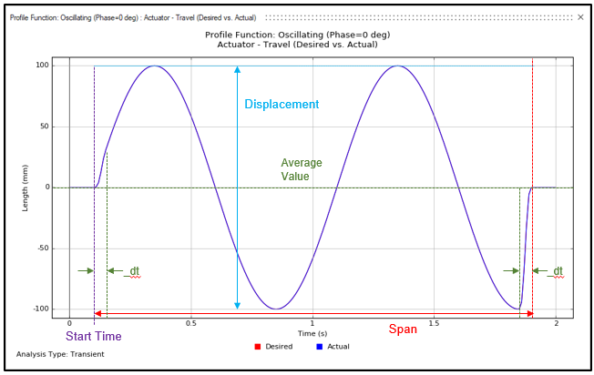

Parameters available in the Profile Editor vary based on what profile function is selected.
- Span
The time span from when the waveform begins to when it ends. For example, in the figure below, the time span is 1.8.
The Span and dt are related as the profile curve ramps up over time dt and tails off over time dt to prevent discontinuity in the profile.
