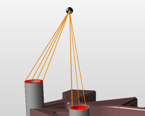

In most cases you will want to create a concentrated mass at a distance. You can do this either by creating the mass at a point on your model and then moving it away, or by creating a point in space and then applying the mass to that point.

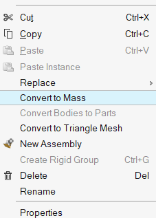

Convert Part to a Mass
Convert a part or parts to a point mass to simplify the simulation and make it run faster.

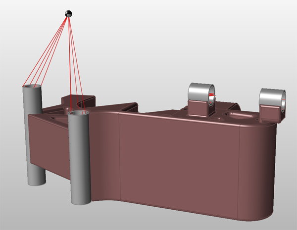

Applying Connectors
When you create a concentrated mass, you will generally want to connect it to geometry features on your model using connectors, which are shown as red features.
