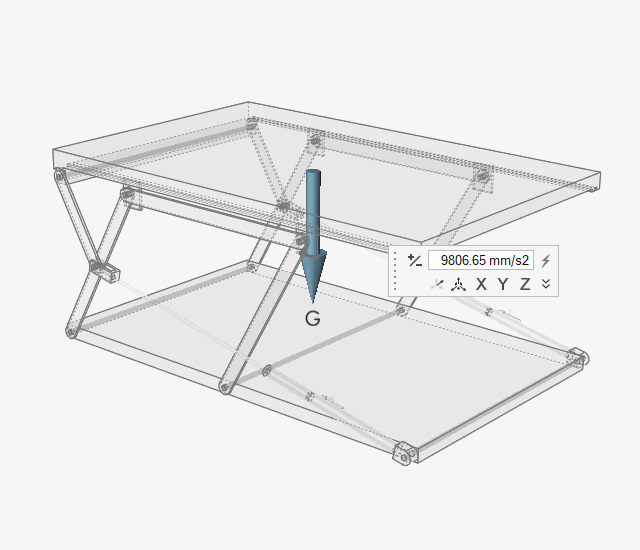

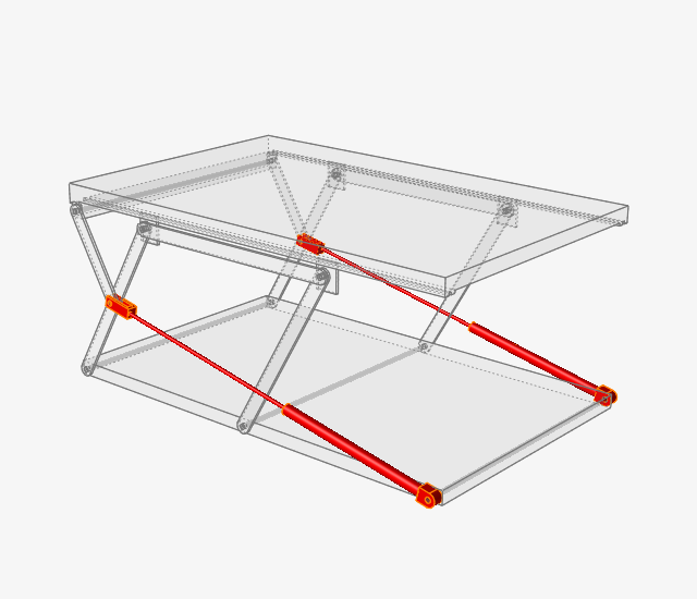

- Add an actuator to the model
- Determine the direction of gravity

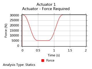

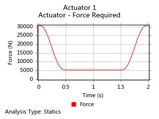

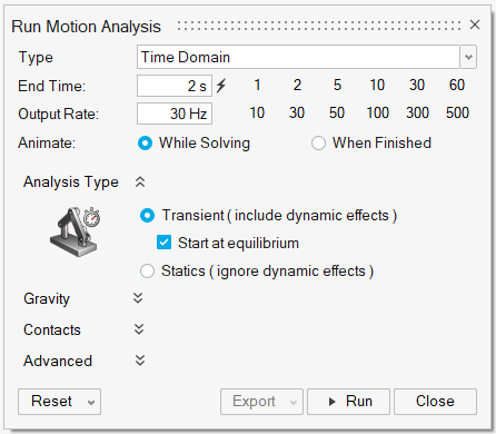

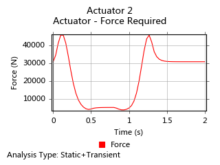

- Run transient and statics motion analyses
- View and plot the results
