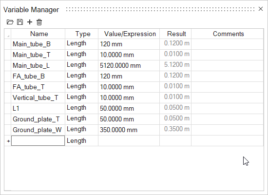

On the Geometry ribbon, select the Variables tool.
The Variable Manager is displayed.
These variables were generated when sketching. It is best practice to make sure that all parts are fully constrained in the model when creating geometric variables. For details on how to create variables, see Video Tutorial: Creating a Parametric Part.
- For Main_tube_L, confirm that the Length is 5120 mm.
- Close the Variable Manager.

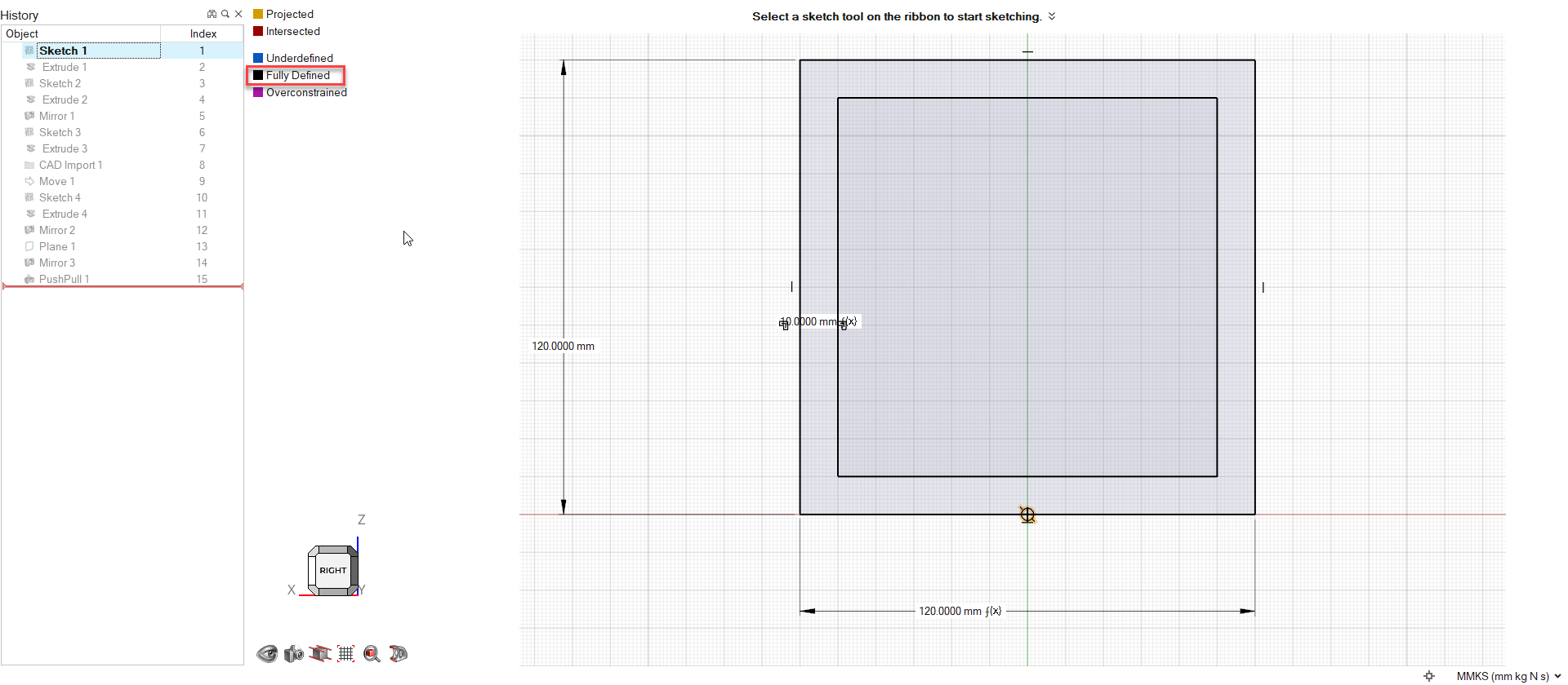

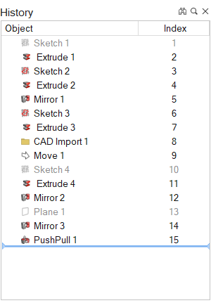

Press F6 to open the Construction History Browser.
Double-click Sketch 1. The sketch is black, indicating
that it is Fully Defined.
- Double-click Extrude 1. This is where the Main_tube_L variable was defined. To see the full entry, click in the Extents field and scroll all the way to the left Main_tube_L=4120.0000 mm. This portion of the model is fully defined.
- Close the Extrude tool.
- Close the Construction History Browser.

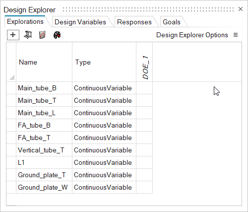

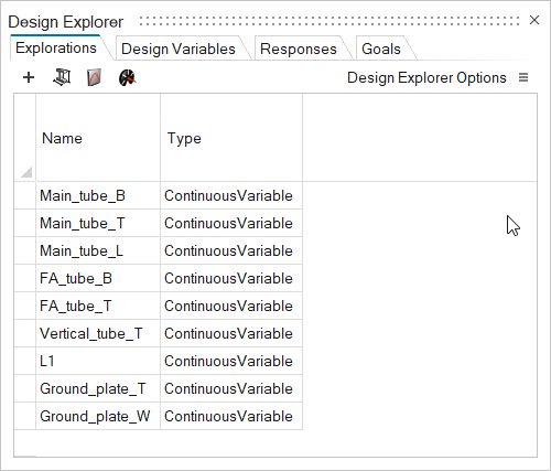

From the Design Explorer ribbon, select the Explorations
tool.
All geometric variables that are not linked to other variables are automatically converted to Design Variables.
On the Explorations tab, click + Add Exploration, and
then select DOE.
An active DOE is created.

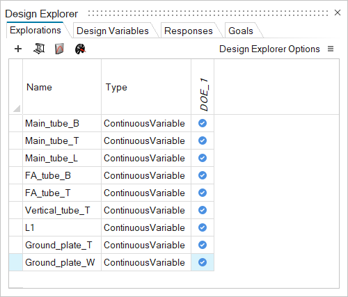

Under DOE_1, select the empty cells to activate all
variables.

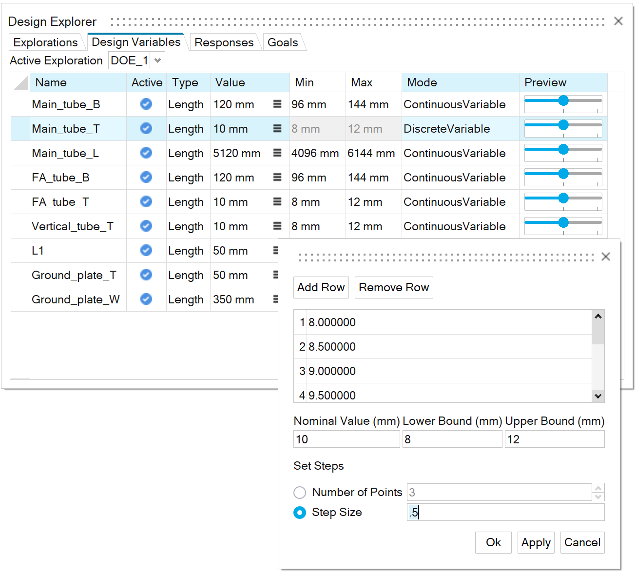

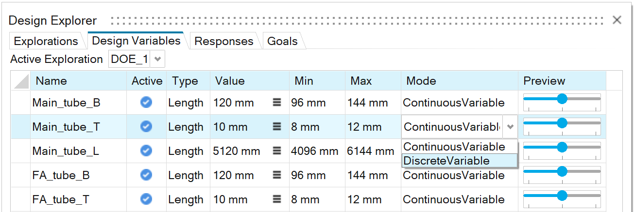

For Main_tube_T , change the Mode
to Discrete Variable.
In the Main_tube_T row, Value
cell, select
for more options.
Turn on Step Size, and then enter
.5.
You have now set the Length of Main_tube_T to discrete increments of 0.5 mm between 8 and 12 mm. - Click Ok.
.5.

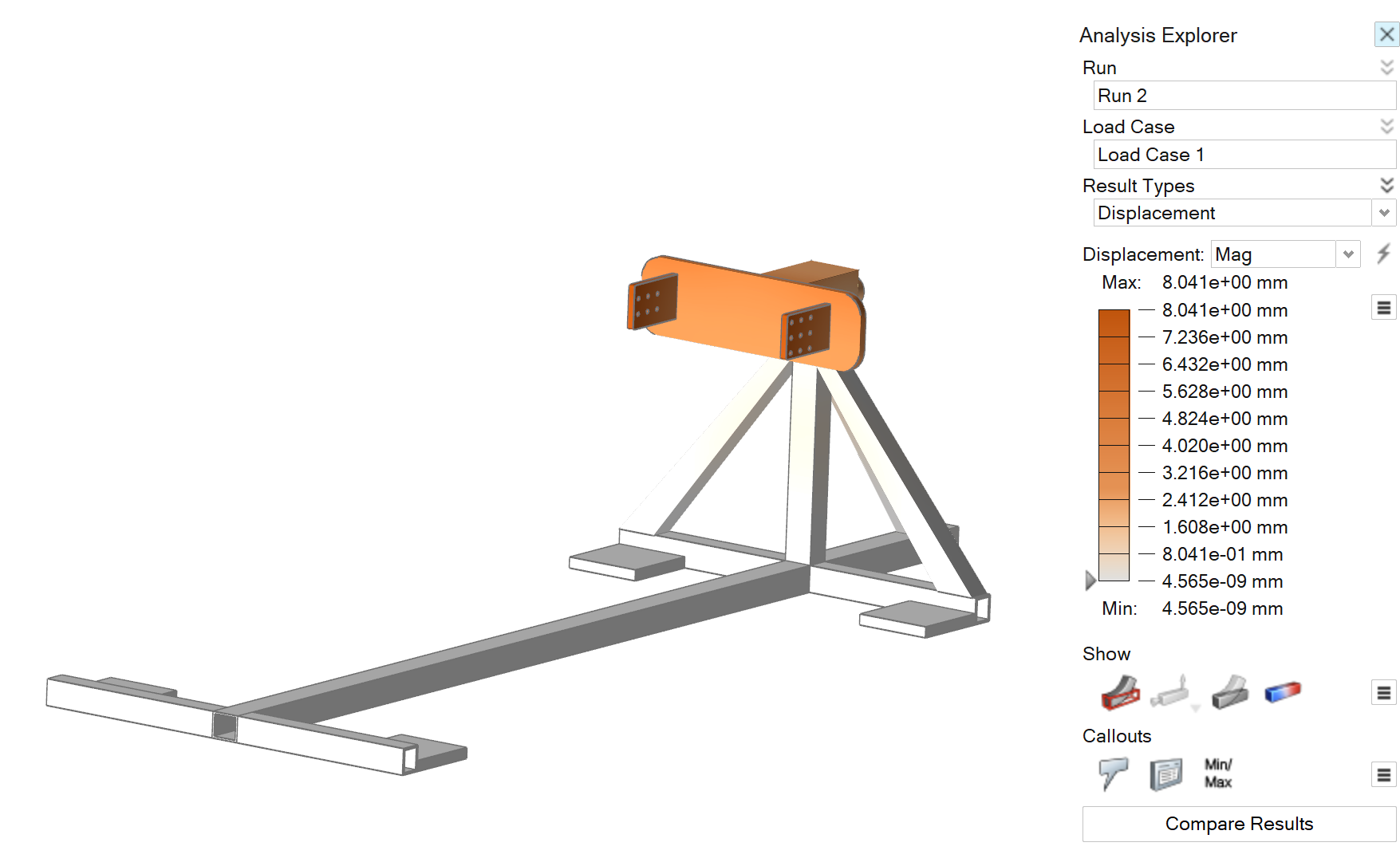

To Do this Review run results In the Status column of the Run Status dialog, double-click a completed run. Display run errors In the Status column of the Run Status dialog, mouse over a failed run to display a possible error message. Review error logs In the Run Status dialog, right-click a failed run, and then select Open Run Folder.

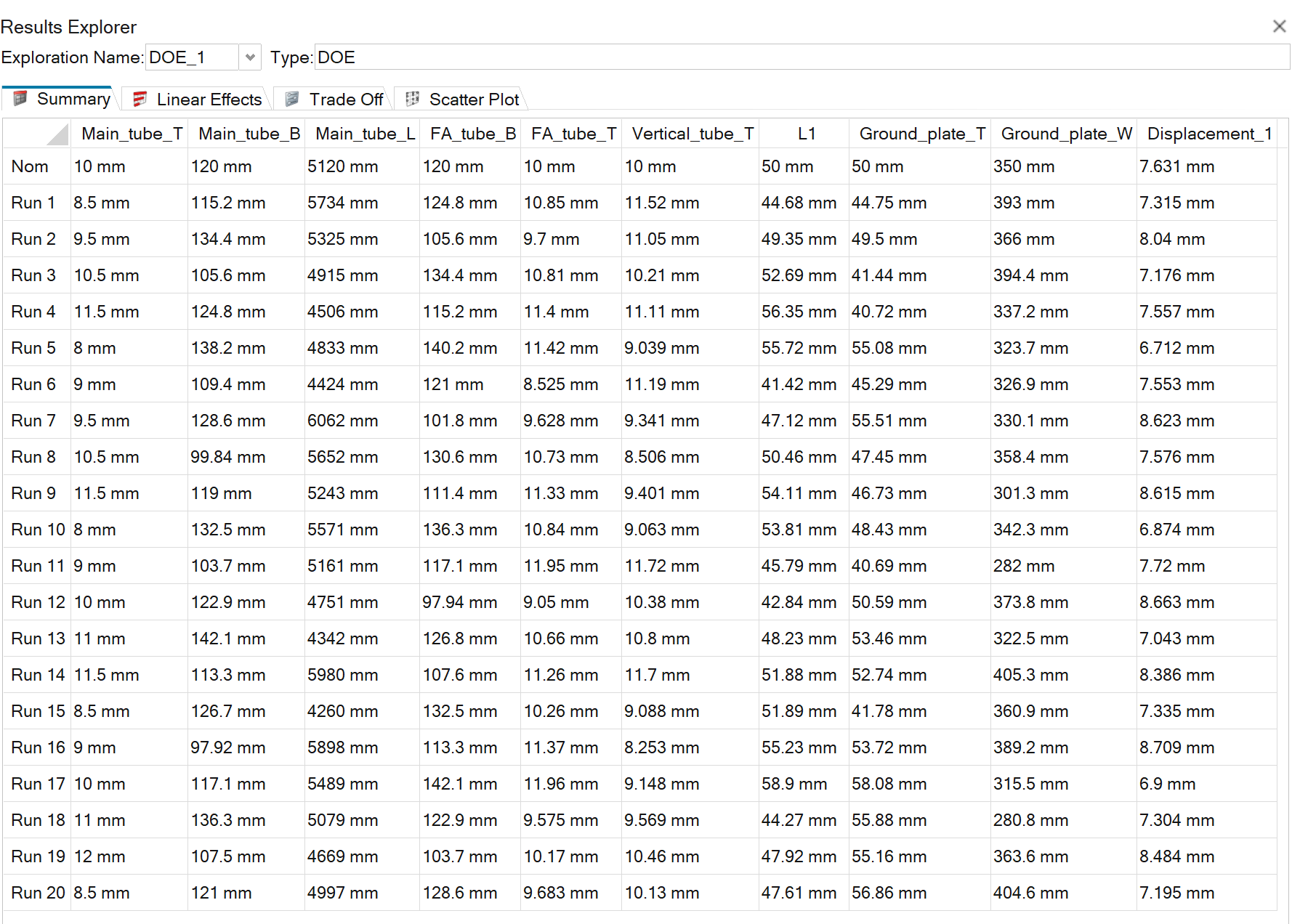

From the Design Explorer ribbon, select the Results
Explorer tool.
The Results Explorer browser opens.
There are 4 tabs of results: Summary, Linear Effects, Trade Off, and Scatter Plot. -
Select the Summary Table
tab.
The Summary Table shows a run-by-run summary of the exploration. The columns show the input design variable values for each run and the corresponding response values. For more information, see Summary Table. -

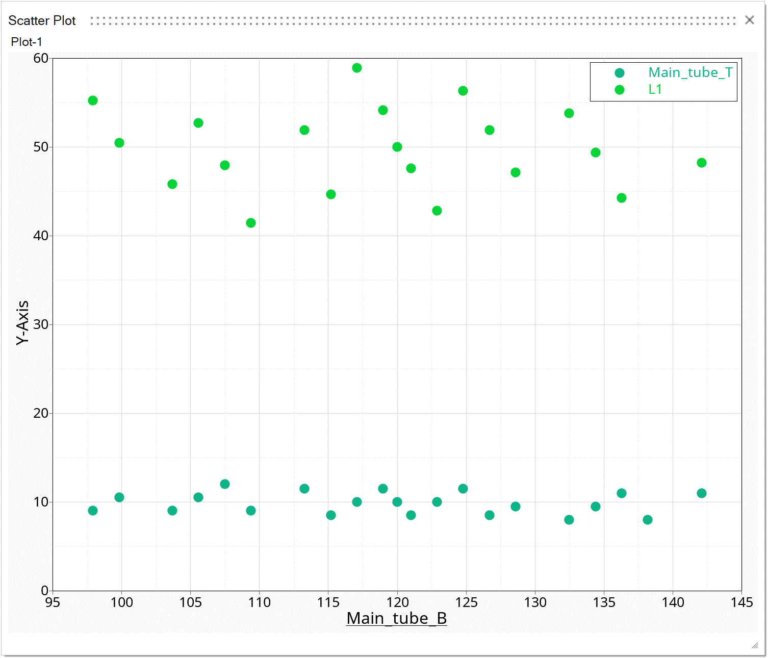

Select the Scatter Plot
tab.
A scatter plot is a 2-dimensional plot showing trends or relationships between variables. For more information, see Scatter Plots.
