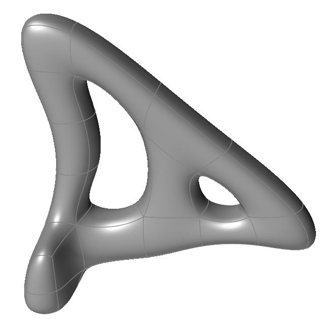

Select the Part to Print
Select the Print Part icon on the
Print3D tab.
Select the PolyNURBS Block 1 part in the modeling window
to designate it as the part to be printed.

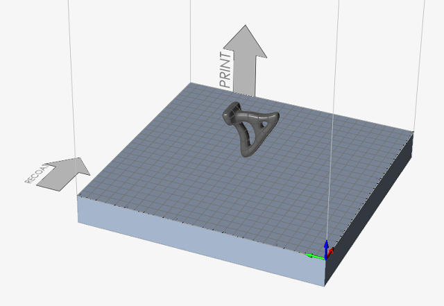

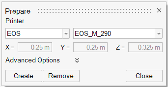

Configure the Printer
Click the Printer icon to configure the printing bed.
Choose the EOS_M_290 printer.
- Click Create. The part appears in the configured 3D printing bed.
Scroll to zoom in on the part.

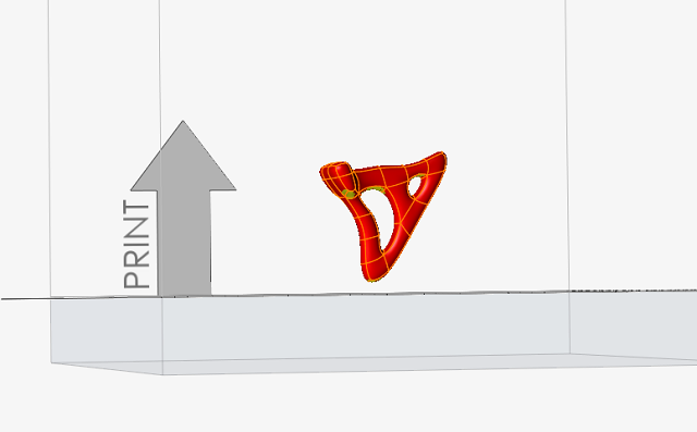

Orient the Model
Click the Orientation icon.
Click the Maximum Build Height icon. You may need to
click the icon twice to get the correct direction.
This orientation will maximize the build height to protect the part from cooling deformations.

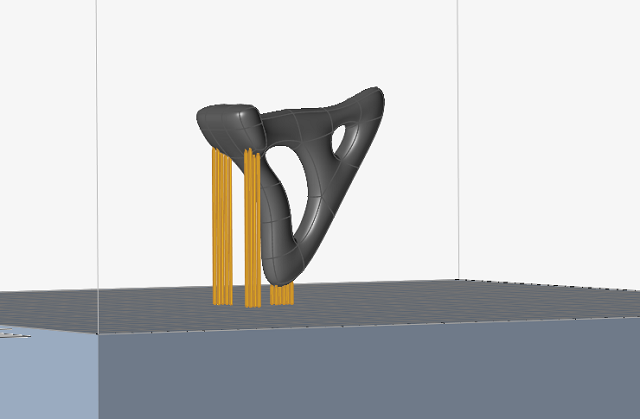

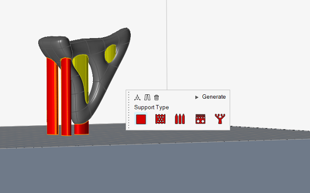

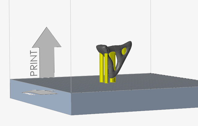

Support the Model
Click the Create Supports tool on the Support
icon.
Inspire auto-generates a support preview, which can be configured according to design needs. This automatically generated support cannot be printed as it appears.

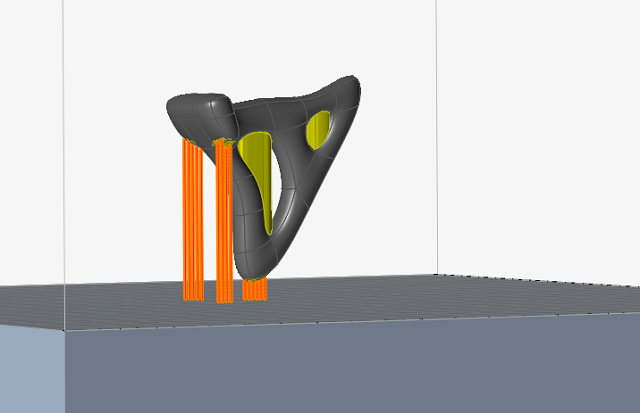

Hold the Ctrl key and select the supports shown below to
edit them. The selected supports turn red.

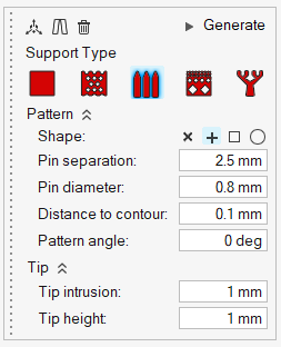

Select the Rod Supports
icon, expand the Pattern section and change the Pin
Separation to 2.5 mm.
Click Generate on the microdialog to generate the
supports.
The selected support previews are converted to rod (pin) supports.

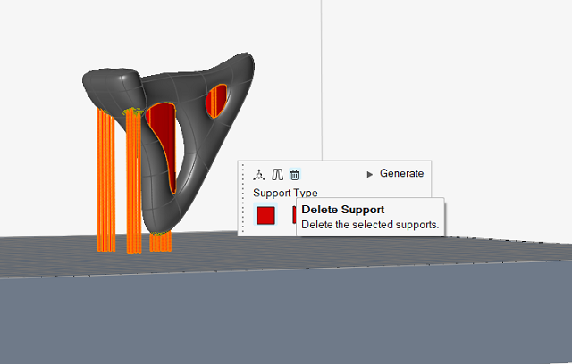

Now select the two supports in the interior holes and click the
Delete icon on the microdialog.
Note: Normally we would reposition the supports in the interior holes, but for this first tutorial we will simply delete and run the analysis without them. -
Right-click and mouse through the check mark to exit, or double-right-click.
Your model should look similar to the image below.

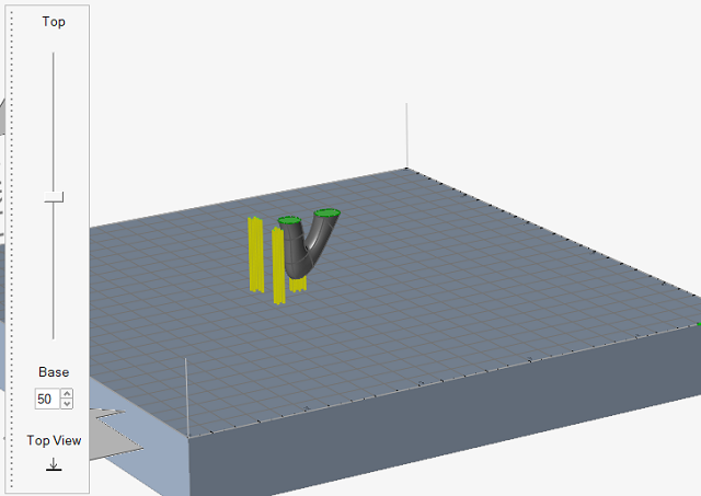

Slice the Model
Click the Slice icon.
Drag the slider from the Base toward the Top to review the the progression of
the printing layers. Gradual changes in the geometry from layer to layer are
needed for successful additive layer manufacturing.

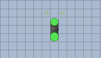

Click Top View
to observe the part from above, as if looking down
at the printing bed.

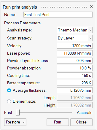

Run an Additive Manufacturing Analysis
Click the
button on the Analyze
icon.
Set your process parameters. Select Thermo-Mechanical
for the Analysis type to generate all of the available
analysis types.
- Set the slider bar to Fast and use the defaults values for the other parameters.
Click Run to run the analysis. A green flag is displayed
over the Analyze icon when the analysis is complete.

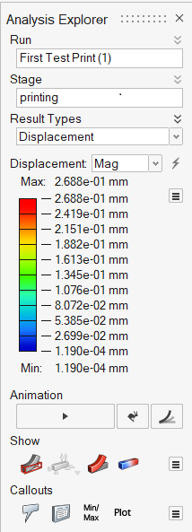

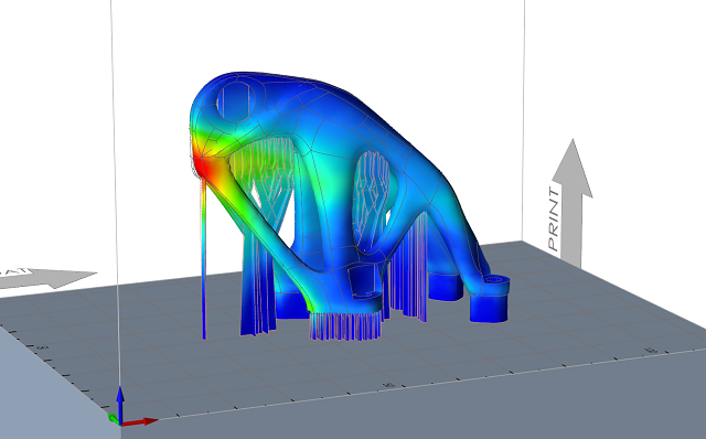

Review the Analysis Results
When the run has completed successfully, click the Show Analysis
Results tool on the Analyze icon to open
the Analysis Explorer.
The displacement result type is displayed in the modeling window. The area of
greatest displacement is shown in red.
- Review the results for plastic strain, von Mises stress, temperature, and nodal temperature. Note how the results for the temperature and the nodal temperature are different.
- Try animating the results to see how the temperature changes during the printing simulation.

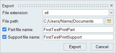

Export the Model and Supports
Click the Export icon.
- Navigate to the File path where you want the exported files to be saved.
- Verify that both the Part and Support check boxes are enabled and name the files as desired.
- Click Export. The part and support files are generated separately and can be found in the File path location.
