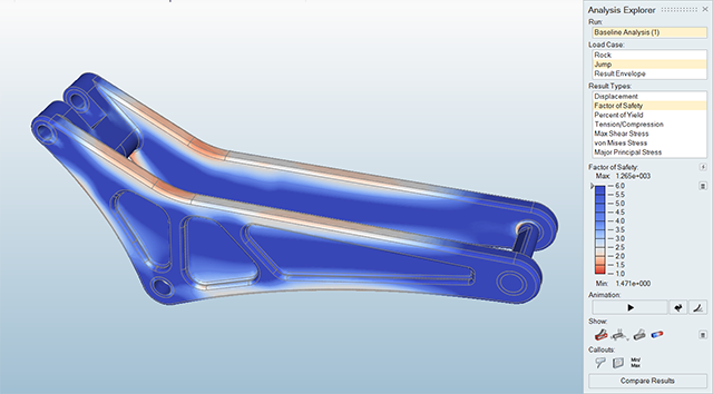

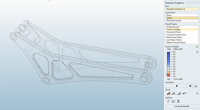

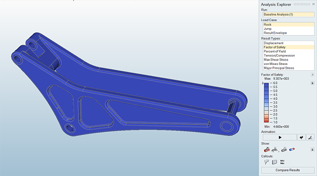

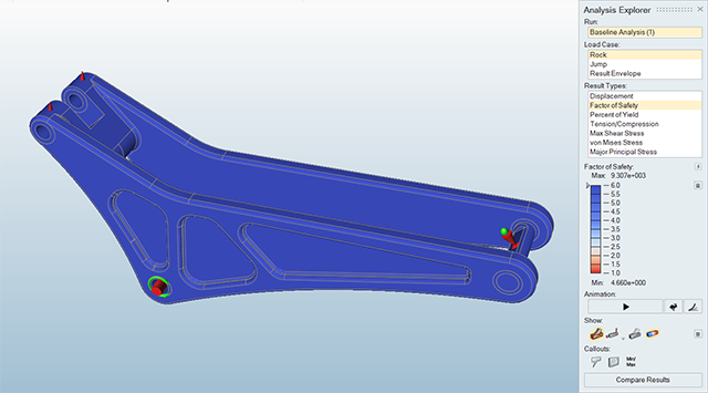

- View results for the factor of safety

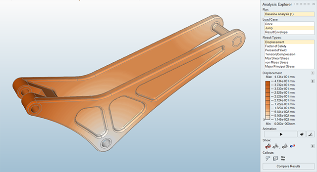

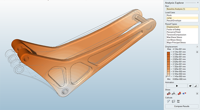

- View results for displacement

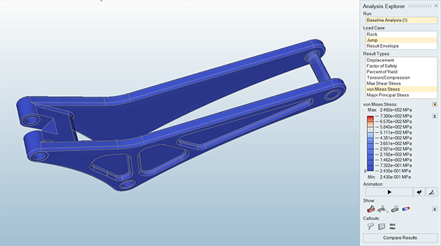

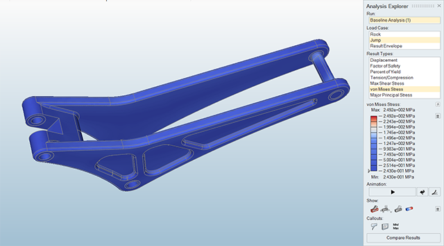

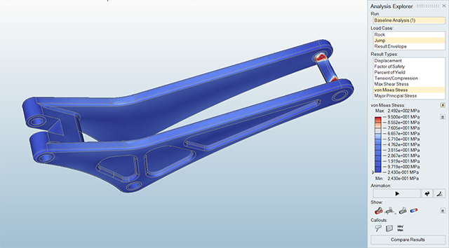

- View results for von Mises stress

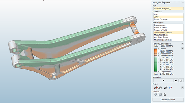

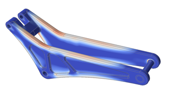

- View results for tension and compression

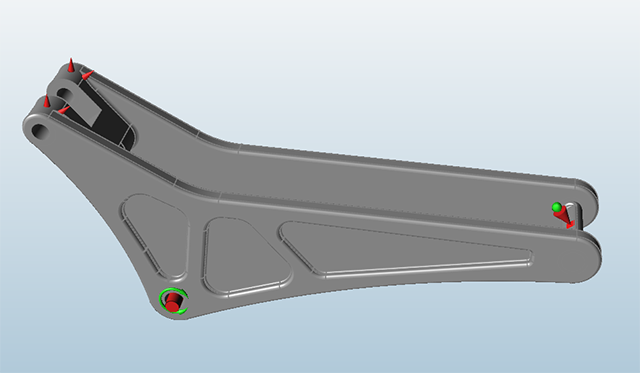

In this tutorial, you will run a baseline static analysis of a part in a steady state and review the results.
- K: is the global stiffness matrix
- x: is the displacement vector response to be determined
- f: is the external forces vector applied to the structure

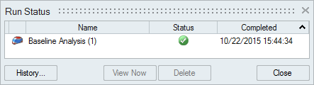

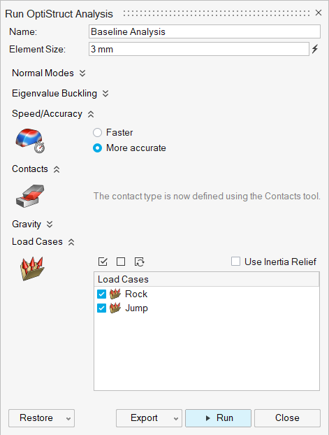

on the Analyze icon to open the Run Analysis
window.
button under Animation to visualize the displacement.
button to stop the animation.
