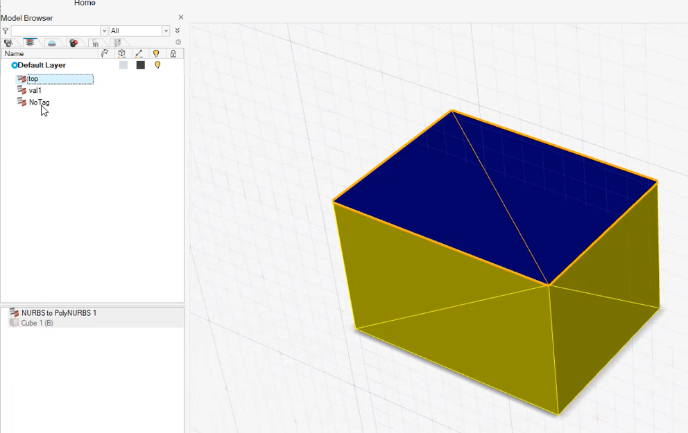

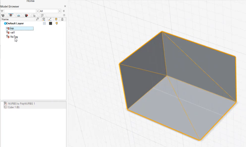

                If you have NURBS objects with tags, you can organize entities into layers
                    according to their tag name and value:
- In the guide bar, select Separate per Tag.
A list of assigned tag names is displayed directly to the right.
 - Select the desired tag name, and then click Update per Tag.
For example, the top face and two side faces have the same tag name but different tag values. The top face (tag value of top) is shown in blue and placed in the top layer. The two side faces (tag value of val1) are shown in yellow and placed in the val1 layer.
The remaining three faces don't have tags and are placed in the No Tag layer. - In the guide bar, select Separate per Tag.
