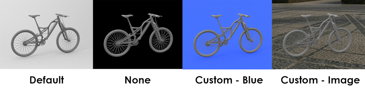

Only available for Background Map. Scale To resize the background map, enter a scale factor. Only available for Background Map.  - Right-click and mouse through the check mark to exit, or double-right-click.
Figure 1. Background Maps
