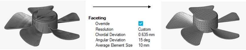

- Real-time Tessellation Control
- This feature enables a "direct from CAD" workflow when dealing with
geometry parts. Geometry parts that need to be tessellated as STL parts
can be more precisely controlled. Every geometry part has independent
tessellation parameters. You can edit these settings to see a live
rendering of the tessellation and adjust the settings on the
go.Note: This feature does not create a continuous surface mesh across parts, but rather an independent triangulation on each one. It is the user's responsibility to ensure that the CAD model and the resulting tessellation is suitable for simulation and does not contain large gaps or intersections.

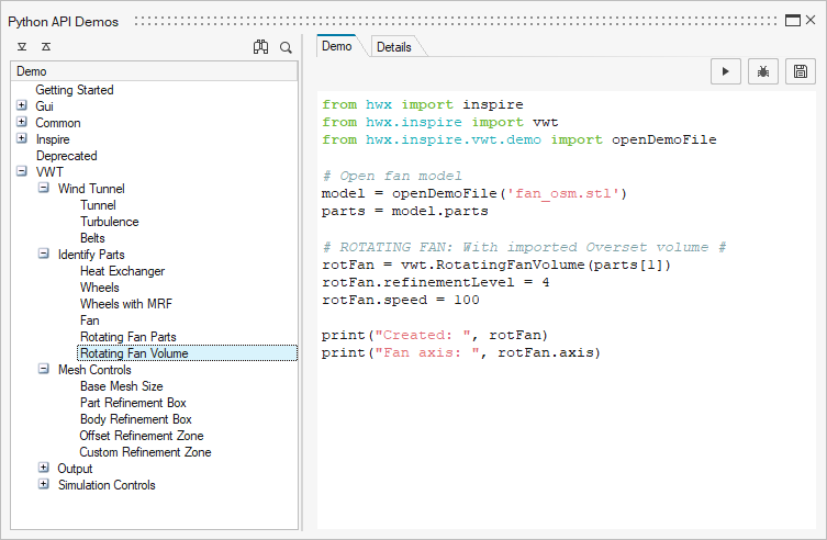

Figure 1. - Python API Demos
- An interactive Python demo tool has been added to the Help menu.
Snippets of Inspire and VWT Python API can be run in the demo window as
a live tutorial with edits. These snippets can be copied to the Python
window and run as part of a larger project setup. These demos help the
user to learn and understand the python API as they build scripts to
automate setup with VWT in batch mode.
