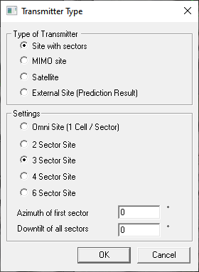

Specify the transmitter type and settings using one of the following
workflows:
- On the Project menu, click Sites > Site: New.
- On the Project toolbar, click the
Set Site icon.
Under Settings, click 3 Sector
Site.
Figure 1. The Transmitter Type dialog. -
Click OK to close the Transmitter
Type dialog.

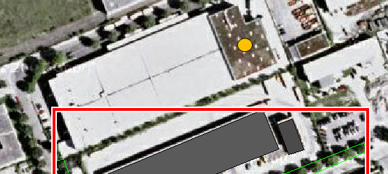

Click near point (X, Y) = (143.88, 187.90) in the 2D view to place the site
(the location of the antenna site is indicated by an orange circle).

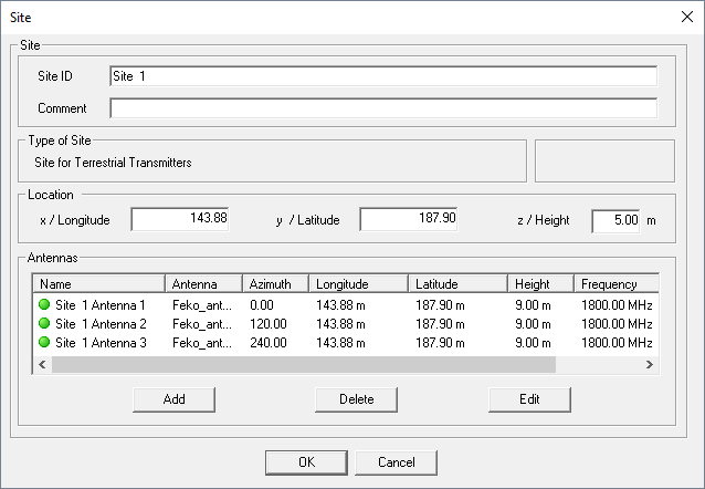

Figure 2. A partial view of the 2D view. Place the antenna site at the location of the orange dot.Note: The exact coordinates is not important for this example, but the above coordinate is used in the steps that follow.Tip: The coordinates at the current mouse cursor are displayed in the Status bar.The Site dialog is displayed. - In the z / Height field, enter a value of 5 m.
Click on Site 1 Antenna 1 to select and click
Edit.

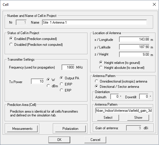

The Cell dialog is displayed for antenna 1.
- Under Transmitter Settings, in the Frequency (used for propagation) field, enter a value of 1800 MHz.
- Under Location of Antenna, in the z / Height field, enter a value of 9 m.
- Under Antenna Pattern, click Directional / Sector antenna.
Select to browse to the file
farfield_gain_3d.ffe1.
Figure 3. The Cell dialog for antenna 1. - Click OK to close the Cell dialog.
- Repeat Step 6 to Step 10 to define antenna 2.
Repeat Step 6 to
Step 10 to define
antenna 3.
Figure 4. The Site dialog. - Click OK to close the Site dialog.
