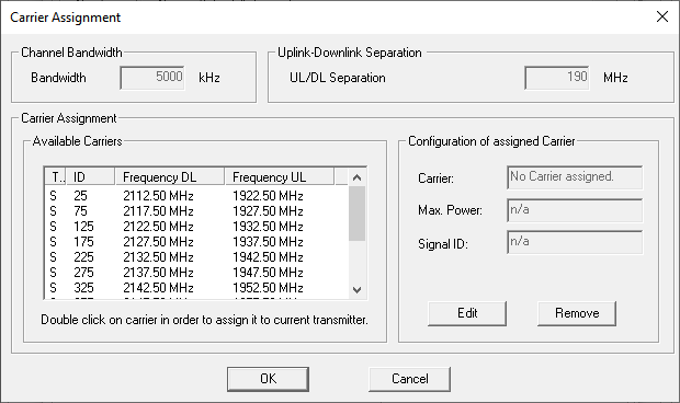

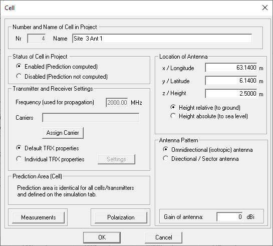

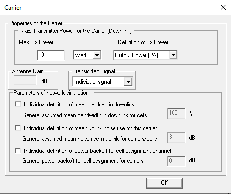

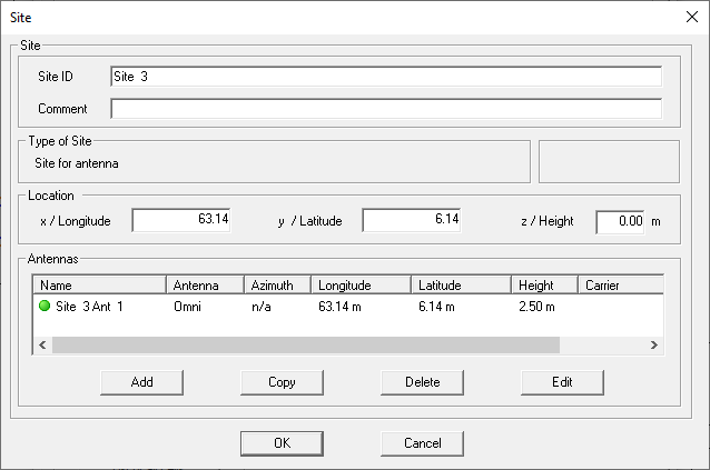

Define the third site, place the third omnidirectional antenna at this location, and assign a carrier. The antenna is placed at a height of 2.5 m above ground.

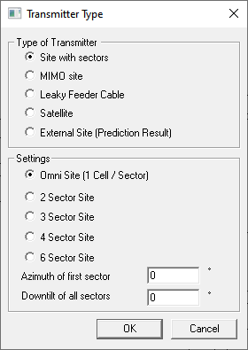

Define the three base station sites, antennas and carriers.

Define the first site, place the first omnidirectional antenna at this location, and assign a carrier. The antenna is placed at a height of 2.5 m above ground.
Define the second site, place the second omnidirectional antenna at this location, and assign a carrier. The antenna is placed at a height of 2.5 m above ground.
