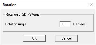

Rotate Pattern
The values in the pattern can be rotated via the menu . After selecting this menu item, the following dialog appears:
Figure 1. Settings for rotation.
You can now rotate the values in the pattern. This is especially important if non-WinProp file formats are imported and their coordinate systems have a different orientation (for example, in the vertical pattern the 0° is in the horizontal plane and 90° are towards the ground. Then the whole pattern can be rotated with –90° to have it in the WinProp format).
