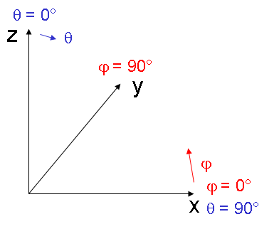

* Theta Phi Attenuation
* Vertical Horizontal relative to iso
