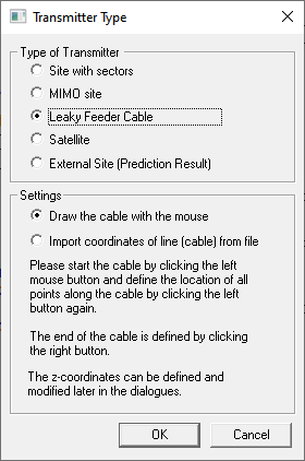

Leaky feeder cables can be created using the mouse tool or by importing the coordinates
of the cable from an ASCII file. New cables can be inserted by choosing or by selecting the
icon. Afterward, a dialog opens, where
the type of the new transmitter can be selected.
Figure 1. The Transmitter Type dialog.

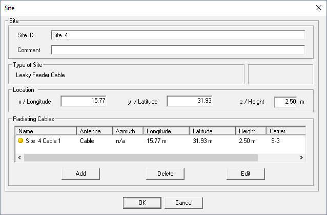

Modification of Parameters
Parameters of leaky feeder cables can be modified by selecting the site to be edited on the Sites tab of the Project dialog or by using the corresponding toolbar icon.
Figure 3. The Site dialog.

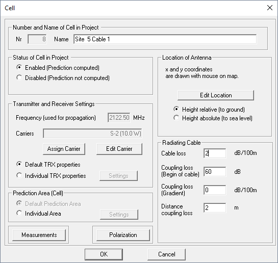

After selecting the cable, the following dialog is displayed:
Figure 4. The Cell dialog.

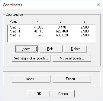

- Location of Cable
- The coordinates of the cable definition points can be edited, imported or
exported from or to an ASCII file using the following dialog.
Figure 5. The Coordinates dialog.Note: The z-coordinates displayed in this dialog are always absolute coordinates. - Cable Loss [dB/100m]
- The cable loss is based on resistance (Ohm) and frequency dependent losses of a cable. The value must be specified in dB per 100 meters. Reasonable values are between 1 and 30 dB per 100 meters. This parameter is used to determine the loss along the whole cable. Depending on the length of the cable an additional loss will be determined
- Coupling loss (Begin of cable) [dB]
- The coupling loss is the attenuation applied at a specific distance (distance coupling loss) perpendicular to the radiating cable. A coupling loss of 20 dB combined with a distance of 2 meters leads to a path loss value of 20 dB at a distance of 2 meters from the feeding point (source) of the cable.
- Coupling loss (Gradient) [dB/100m]
- The coupling loss can be reduced by defining a (positive) coupling loss gradient. If the coupling loss at the begin of the cable is 10 dB for example and the coupling loss gradient is 2 dB/100m, then the coupling loss at the end of a 100-meter long cable is 8 dB. Along the cable, there is a linear decrease in the coupling loss.
- Distance coupling loss [m]
- This parameter is the distance used to determine the path loss based on the coupling loss. It must always be seen in relation to the coupling loss
