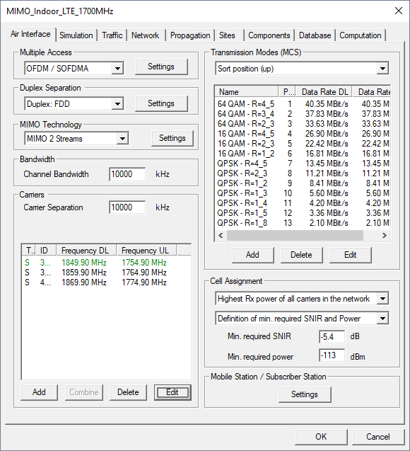

For considering MIMO antennas in the WinProp radio network planning project, first the MIMO scheme has to be selected on the Air Interface tab. Depending on the selected MIMO scheme, a number of separate MIMO data streams is considered, up to MIMO 8x8 with eight parallel streams.
Figure 1. Air Interface definition including MIMO technology.
When you click the Settings button, further properties of the MIMO antenna system can be specified.

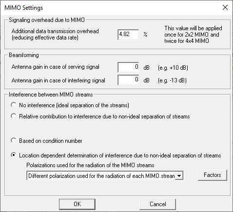

Signaling Overhead
When transmitting multiple data streams in parallel due to spatial multiplexing, there is an additional signaling overhead required which reduces the effective achievable data rate. The defined signaling overhead value (see Figure 2) is considered once for MIMO 2x2, 1.5 times for MIMO 3x3, twice for MIMO 4x4, and so on up to four times for MIMO 8x8.
Beam forming
Beam forming at the transmitter can be achieved by spatial processing. In this case the same signal is emitted from each of the transmit antennas with appropriate phase weighting such that the signal power is maximized at the receiver input.
The benefits of beam forming are to increase the received signal gain, by making signals emitted from different antennas add up constructively, and to reduce the multipath fading effect. Spatial multiplexing can also be combined with beam forming when the channel is known at the transmitter.
In the absence of scattering, beam forming results in a well defined directional pattern, thus increasing the antenna gain for the desired signal and reducing the antenna gain for the interfering signal. Consequently the antenna gains for the serving and interfering signals can be defined in the MIMO settings if beam forming is utilized. These values shall be kept to 0 dB if no beam forming is applied.
See Figure 2 for the settings related to beam forming.
Interference between MIMO streams
Spatial multiplexing by using MIMO antennas allows to increase the throughput depending on the signal-to-noise-and-interference ratio (SNIR). The SNIR is also influenced by the interference between the different MIMO streams.
- No interference (ideal separation of different streams)
- If different polarizations are used (for example, vertical polarization for MIMO stream 1 and horizontal polarization for MIMO stream 2) the streams are well separated, especially in LOS areas. Thus a simple assumption consists in neglecting the interference between the different MIMO streams.
- Relative contribution to interference due to non-ideal separation of streams
In this case an overall ratio for the interference between the different streams is specified. For example, 20 dB which means that for a MIMO 2x2 system the received power for MIMO stream 1 will increase the interference level for MIMO stream 2 (received power minus 20 dB) and vice versa. This option considers a constant relative interference impact over the whole simulation area (considering the individual received power values for each stream at each location).
Alternatively, specify the envelope correlation coefficient (ECC) of the mobile station's antennas. While a universal relation between interstream interference and ECC does not exist, the following can be expected in practice:
ECC <= 0.01 MIMO interstream interference of 20 dB
ECC = 0.1 MIMO interstream interference of 16 dB
ECC = 0.5 MIMO interstream interference of 12 dB
- Based on condition number
- The condition number of the channel matrix is used to determine the interference between MIMO streams.
- Location dependent determination of interference due to non-ideal separation of streams
This option considers the individual receiver location and the properties of the radio link (LOS/NLOS) for the interference impact. In order to ensure high accuracy the user shall define if different polarizations are used for the individual MIMO streams (for example vertical polarization for MIMO stream 1 and horizontal polarization for MIMO stream 2), which reduces the interference, especially in LOS conditions.
The options to use the condition number or the localization-dependent interference can be used for simulations with ray-tracing methods. The condition number should be the most accurate option however only in cases there are many ray paths with significant power to the mobile station. The localization-dependent interference is rather complex to be used because of the many parameters.Note: In cases with widely-separated MIMO antennas on the mobile station (for example, separated by several or many wavelengths), the paths from the base station to each of the mobile station's antennas are noticeably different, which means the correlation between them will be low, so you may as well choose to use the option for MIMO interstream interference with a large value for the ratio.
Figure 2. The MIMO Settings dialog.
