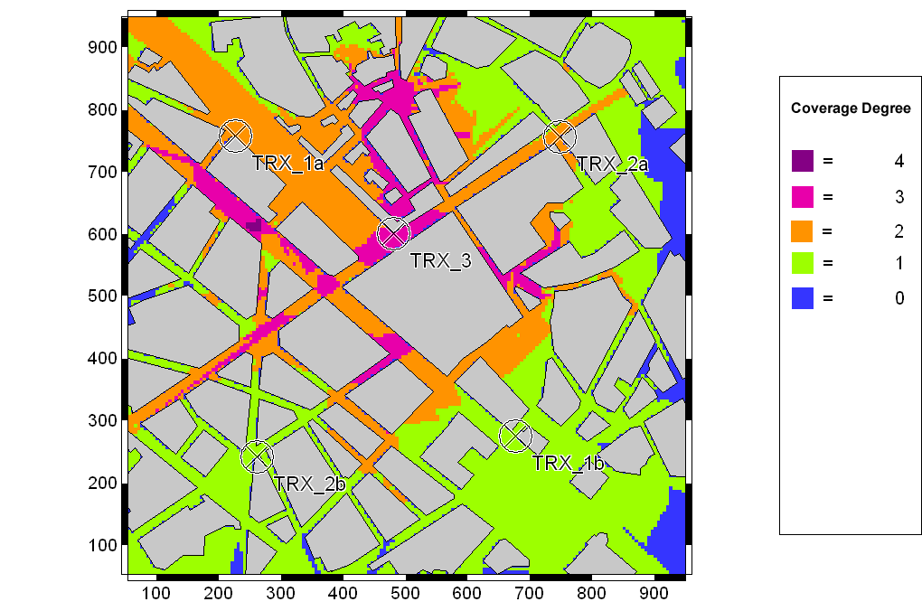

Coverage Degree (Number of Channels Higher Than Threshold) (.fpn)
For every prediction pixel, the number of base stations where the predicted received power is above a user-defined threshold is computed. This threshold can be changed in the prediction parameter section of the ProMan. The result reflects the coverage degree in the individual positions.
Figure 7 shows the coverage degree result. It is visible that in some areas a bad coverage (degree of 0) is achieved.
