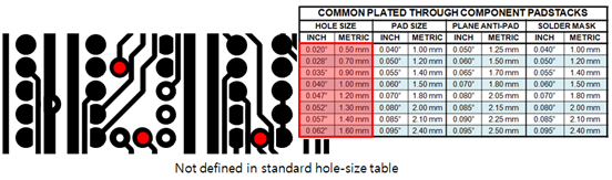

Drill Scan
Check the non-standard size of a drill hole.
- Target Objects Definition: Set the target object for analysis. Among the
following objects, select all necessary target objects.
- Via Hole Size
- DIP Type Pin’s Hole Size
- Board Figure Hole Size
- Size Difference Checking: Depending on manufacturers, there may be different
standard drill hole sizes. Make the table for standard hole size using the
following table menu.
Figure 1.- Item: Specify the item name.
- Scan Range: Set target hole size value ranges.
- Base Value: Among the holes that have sizes in the scan range, PollEx DFM checks the size of the hole and if their values are not matching with the base value, they will be detected as fails.
