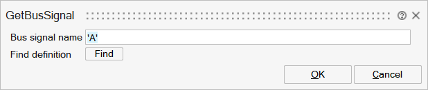

This block connects bus ports from a block to another without connecting them physically. It is used with a SetBusSignal block. A simple SetBusSignal block can send data to multiple GetBusSignal, although a GetBusSignal can receive data from only one SetBusSignal. SetBusSignal transports its input data to its corresponding GetBusSignal block.
    GetBusSignal
Activate/BusOperations
The GetBusSignal block connects bus ports from one block to another without connecting them physically. It is used with a SetBusSignal block. A simple SetBusSignal block can send data to multiple GetBusSignal blocks, although a GetBusSignal can receive data from only one SetBusSignal. SetBusSignal transports its input data to its corresponding GetBusSignal block.
For more information, please refer to the GetSignal block.
GetBusSignal_0
tag
Bus signal name
String
Port 1
bus
output
1
