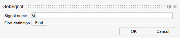

This block receives signals from a corresponding SetSignal block by connecting the regular ports of the blocks without using a link. A single SetSignal block can send signals to multiple GetSignal blocks, but a GetSignal block can receive signals from only one SetSignal block.
    GetSignal
Activate/Routing
The GetSignal block connects bus ports from one block to another without connecting them physically. It is used with a SetSignal block. A simple SetSignal block can send data to multiple GetSignal, although a GetSignal can receive data from only one SetSignal. SetSignal transports its input data to its corresponding GetSignal block.
The scoping of a signal is defined by the SetSignal block. A GetSignal will search first to a local signal then to a scoped signal and at the end to a global one.
