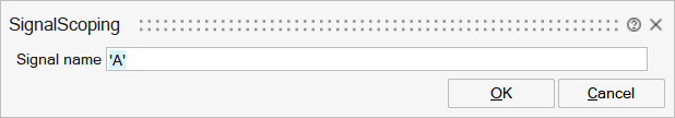

tag
Signal name
Specify the name of the input signal.
String
