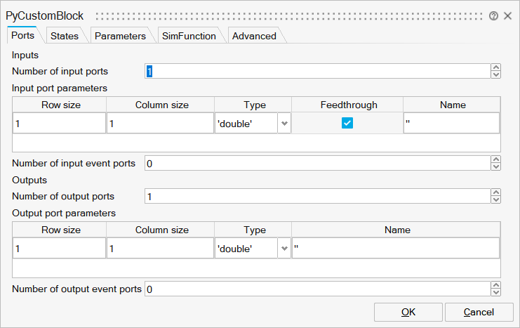

nin
Number of input ports
Number
inports
Input port parameters
Structure
inports/inrow
Row size
Cell of scalars
inports/incol
Column size
Cell of scalars
inports/it
Type
Cell of strings
'double'
'complex'
'int32'
'int16'
'int8'
'uint32'
'uint16'
'uint8'
'boolean'
inports/depu
Feedthrough
Cell of scalars
0
1
inports/name
Name
Cell of strings
nevin
Number of input event ports
Number
nout
Number of output ports
Number
outports
Output port parameters
Structure
outports/outrow
Row size
Cell of scalars
outports/outcol
Column size
Cell of scalars
outports/ot
Type
Cell of strings
'double'
'complex'
'int32'
'int16'
'int8'
'uint32'
'uint16'
'uint8'
'boolean'
outports/name
Name
Cell of strings
nevout
Number of output event ports
Number
evoutports
Initial firing values
Structure
evoutports/fir
Firing (<0 for no firing)
Cell of scalars

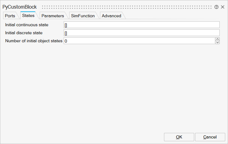

xx
Initial continuous state
Vector
xd
Initial state derivative
Vector
z
Initial discrete state
Vector
noz
Number of initial object states
Number
ozparams
Initial object states
Structure
ozparams/oztyp
Type
Cell of strings
'double'
'complex'
'int32'
'int16'
'int8'
'uint32'
'uint16'
'uint8';
'int64'
'uint64'
'boolean'
ozparams/ozvalue
Value
Cell of matrices
ozparams/name
Name
Cell of strings

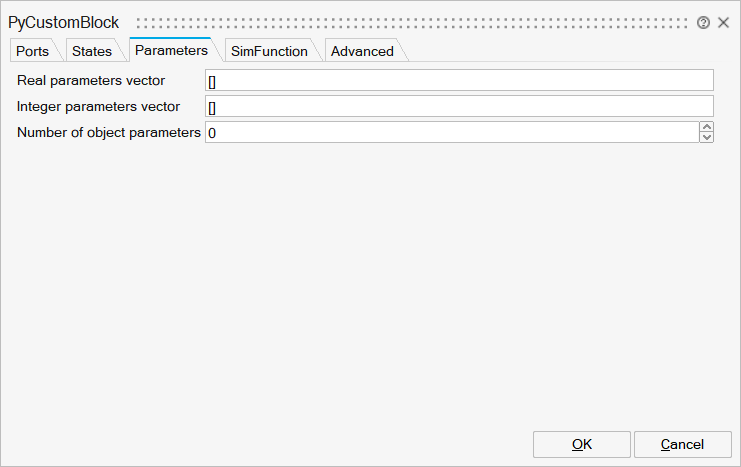

rpar
Real parameters vector
Vector
ipar
Integer parameters vector
Vector
nopar
Number of object parameters
Number
oparparams
Object parameters
Structure
oparparams/opartyp
Type
Cell of strings
'double'
'complex'
'int32'
'int16'
'int8'
'uint32'
'uint16'
'uint8'
'boolean'
'int64'
'uint64'
'string'
oparparams/oparvalue
Value
oparparams/name
Name
Cell of strings

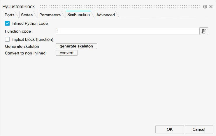

inlined
Inlined Python code
Number
0
1
code
Function code
String
fcn
Function
Structure
fcn/slib
Python file path
Cell of strings
fcn/epoint
Python function name
Cell of strings
impl
Implicit block (function)
Number
0
1

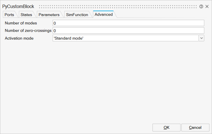

nmode
Number of modes
Scalar
nzcr
Number of zero-crossings
Scalar
dept
Activation mode
String
'Always
Active
mode'
'Initially
Active
mode'
'Standard
mode'
