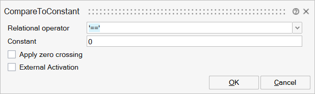

The CompareToConstant block compares input with a constant by way of a relational operator, and produces a double output, 1 for true, and 0 for false.
CompareToConstant_0
op
Relational operator
Operator with which the input will be compared with a constant.
C
Constant
Constant used as the criterion for the comparison based on the relational operator.
zcr
Apply zero crossing
Turn this parameter on to detect the zero crossings. Default is off.
Number
0
1
externalActivation
External Activation
Specifies whether the block receives an external activation or inherits its activation through its regular input ports. When External Activation is selected, an additional activation port is added to the block. By default, external activation is not selected.
Number
0
1
