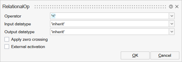

RelationalOp_0
rule
Operator
Relational operations supported by the RelationalOp block are : "==", "~=", "<", "<=", ">" and ">=".
String
typei
Input datatype
Defines the datatype of the inputs.Supported types are : double, int32, int16, int8, uint32, uint16, uint8, boolean, inherit.
String
'double'
'complex'
'int32'
'int16'
'int8'
'uint32'
'uint16'
'uint8'
'boolean'
'inherit'
typeo
Output datatype
Defines the datatype of the output.Supported types are : double, int32, int16, int8, uint32, uint16, uint8, boolean, inherit.
String
'double'
'complex'
'int32'
'int16'
'int8'
'uint32'
'uint16'
'uint8'
'boolean'
'inherit'
zcr
Apply zero crossing
Parameter to activate zero-crossing detection.
Scalar
0
1
externalActivation
External activation
This parameter defines if the block receives an external activation or inherits. When External Activation is used, an activation port is added to the block.
Number
0
1
