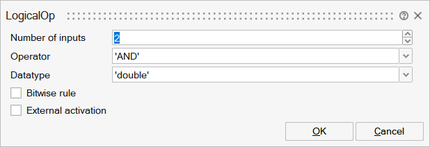

LogicalOp_0
nin
Number of inputs
Number of inputs of the block. Integer value.The operator NOT only supports one input.
Number
rule
Operator
Logical operators supported by the LogicalOp block are : AND, OR, NAND, NOR, XOR, NOT.
String
'AND'
'OR'
'NAND'
'NOR'
'XOR'
'XNOR'
'NOT'
Datatype
Datatype
Defines the datatype of the input and output.Supported types are : double, int32, int16, int8, uint32, uint16, uint8, inherit.
String
'double'
'int32'
'int16'
'int8'
'uint32'
'uint16'
'uint8'
'boolean'
'inherit'
tp
Bitwise rule
If this parameter is set, operators are applied bitwise. It is only applicable to integer inputs.
Scalar
0
1
externalActivation
External activation
Specifies whether the block receives an external activation or inherits its activation through its regular input ports. When External Activation is selected, an additional activation port is added to the block. By default, external activation is not selected.
Number
0
1
Port 1
explicit
output
1
Port 2
explicit
input
nin
Port 3
activation
input
externalActivation
