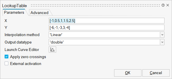

LookupTable_0
xx
X
X values. Vector of doubles of size n (same size as vector Y). The X data vector must be strictly monotonically increasing. It can be either row or column provided Y is the same size.
Vector
yy
Y
Y values. Vector of doubles of size n (same size as vector X). When X is a row vector, Y can be a matrix with the same number of columns.
Matrix
Method
Interpolation method
Interpolation method, to be selected amongst: ZeroOrder(Floor), ZeroOrder(Ceil), ZeroOrder(Nearest), Linear, Not a Knot, Natural, Clamped.
String
'ZeroOrder(floor)'
'ZeroOrder(ceil)'
'ZeroOrder(nearest)'
'Linear'
'Not_a_knot'
'Natural'
'Clamped_To_Zero'
'Akima'
'Fritsch_Butland'
'Steffen'
typ
Output datatype
Defines the datatype of the output of the block. Available datatypes are: double, int32, int16, int8, unit32, uint16, uint8.
String
'double'
'int32'
'int16'
'int8'
'uint32'
'uint16'
'uint8'
'boolean'
'inherit'
EventGen
Apply zero crossings
Enable this parameter to detect the zero crossings. Default is on.
Scalar
0
1
externalActivation
External activation
Specifies whether the block receives an external activation or inherits its activation through its regular input ports. When External Activation is selected, an additional activation port is added to the block. By default, external activation is not selected.
Number
0
1

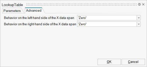

LookupTable_1
Leftside
Behavior on the left-hand side of the X data span
Action that should be taken on the left-hand side of the X data.
String
'Zero'
'Hold'
'Extrapolation'
'Repeat'
Rightside
Behavior on the right-hand side of the X data span
Action that should be taken on the right-hand side of the X data.
String
'Zero'
'Hold'
'Extrapolation'
'Repeat'
