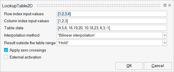

The LookupTable2D block approximates a non-linear function using interpolation on data provided as a "2D-table". This is bi-dimensional and the table is then defined by specifying two vectors (x and y) of size m and n, and a "2D-table", a matrix of size m*n. Output of the block is the approximation of the block input using the selected interpolation method.
Each input can be either scalar, vector or matrix.
LookupTable2D_0
xx
Row index input values
Vector of length m.
Vector
yy
Column index input values
Vector of length n.
Vector
zz
Table data
Matrix of size m x n.
Matrix
Method
Interpolation method
Interpolation method. Default: bilinear interpolation.
String
'Linear'
'ZeroOrder(nearest)'
'ZeroOrder(floor)'
'ZeroOrder(ceil)'
DoOutside
Result outside the table range
Action to be taken with the result outside of the table range.
String
'Zero'
'Hold'
'Linear'
EventGen
Apply zero crossings
Enable this parameter to detect the zero crossings. Default is on.
Scalar
0
1
externalActivation
External activation
