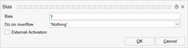

The Bias block adds a constant to the input to produce the output.
    Bias
Activate/MathOperations
Output is computed as follows: y = u + Bias , where Bias is the block parameter.
The Bias can be a scalar or a matrix. If a matrix, its size must match the size of the block input.
Bias_0
b
Bias
The Bias is a real value.The Bias can be a scalar or a matrix. If a matrix, its size must match the size of the block input.
Matrix
over
Do on overflow
String
'Nothing'
'Saturate'
'Error'
