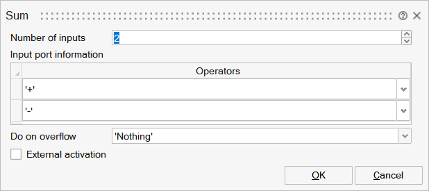

The Sum block performs addition or subtraction on its inputs. This block can add or subtract scalar, vector, or matrix inputs. The number of inputs is given by the first parameter. The second parameter is a list of signs.
Inputs can be either real or complex.
Inputs are either scalar, or vector. If vector, all vectors must be of the same size.
The Sum block can also collapse the elements of a single input vector: In case of a single input, the output is the sum of all elements of the input vector.
Sum_0
nin
Number of inputs
real scalar value.
Number
in_ports
Input port information
Structure
in_ports/sgn
Operators
List of signs (+ or -) to specify the operation applied to each entry, respectively.
Cell of strings
satur
Do on overflow
Defines the action in case of an overflow during the operation. Options are : "Nothing" (gives a normal, non satured result), "Saturate" (gives a saturated result), "Error" (gives an error message).
String
'Nothing'
'Saturate'
'Error'
externalActivation
External activation
Specifies whether the block receives an external activation or inherits its activation through its regular input ports. When External Activation is selected, an additional activation port is added to the block. By default, external activation is not selected.
